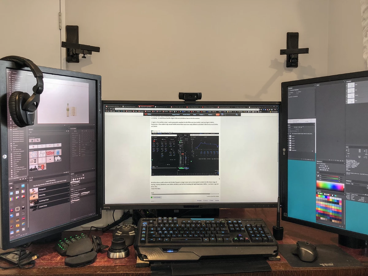

    Dave & Steve, thanks for info.  I am now feeling more encouraged to continue trying to improve my voice audio quality, and I certainly feel better equipped from Steve's info. As I mentioned in the OP, I don't have the Tapcos set up at the moment (they are actually being used with our television until I can run the cables and put the HiFi back together) but you can see from the brackets that I try to have the driver axis directed straight at me and clear of obstruction.  The Logitec speakers are behind the main screen (literally no space to put them anywhere else) and they sound flat and horrible).

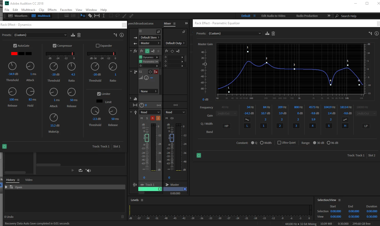

    So just to clarify what I used to clean up the audio a little.
    1. I used an application called VB Cable ( from VB Audio). It allows you to use a "virtual cable" to output from Audition then take that as an input to the Connect live session, thereby inserting the audition mixer into the Connect session mic feed.
    2. In the audition mixer I used a Dynamics effect to add:
    a. A noise gate - to cut out the background fan noise from my PC between speech
    b. A compressor - just to smooth the levels
    c. A limiter - to avoid those horrible digital clicks we sometimes hear on the live sessions
    3. Again in the audition mixer I used a parametric equaliser to roll off the very low (<60Hz ) and very high (>10kHz) frequencies. I then added a dip around 4.6KHz where there was some nasty sibilance and added  little boost around 100Hz and 200Hz
    All of the above could be done with limited frequency range in your ears as most speech content is in the lower range of hearing  anyway (telephony uses 300Hz-3400KHz) and far from boosting the high frequencies >10Khz , I cut them to get rid of any hiss.
    I hope this helps.
