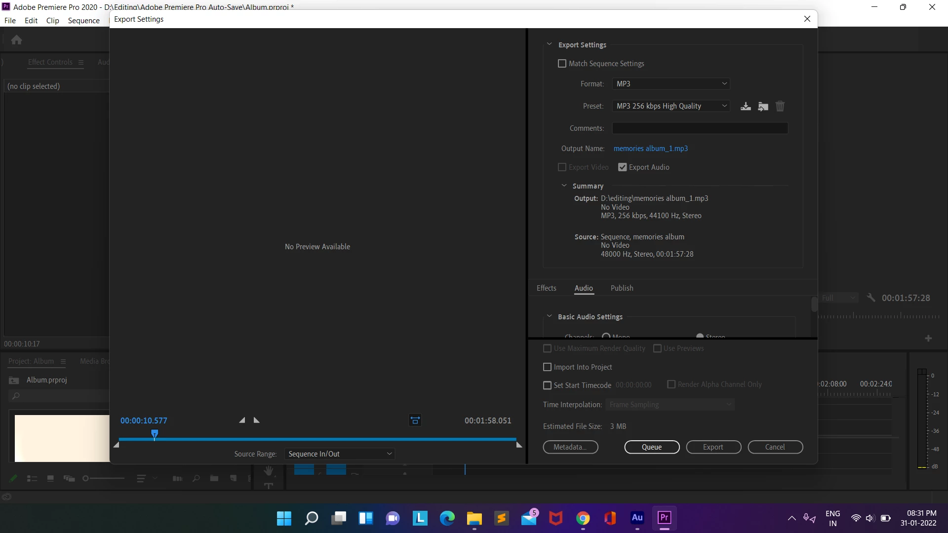

Jan 31, 2022 3:06 PM UTC
Export the .mp3 file in High bit rate (mp3 256 high Quality) in adobe premier pro then use your .srm file on that exported file to remove sound then this error will not come. My error is resolved by doing this hope this helps you.
