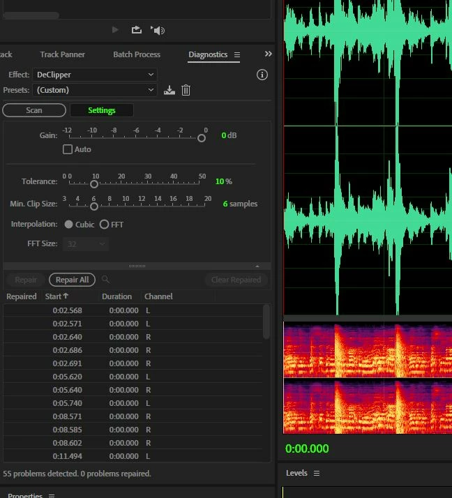

Hey all,
I have some audio that's clipped, but the declipper process isn't running. When I hit the scan button the log says "scan completed in 0.00 seconds" and it doesn't find the clipped sections. I'm assuming this means that the scan process is not running.
I'm running Windows 10 with the most up-to-date version of Audition. The audio is mono but I've tested it on stereo audio with the same result.
Am I missing something here? Any advice would be appreciated.

I'm afraid not. All the valid suggestions are already in the thread. Can you post anexample of the audio that doesn't appear to work?

You probably just need to alter the scan settings - if you have these wrong, nothing appears to be clipped at all. Typically this sort of thing works:
rybert777Author
Apr 16, 2020 4:44 PM UTC
That worked! I needed to change the interpolation to FFT. Thanks a bunch Steve!
