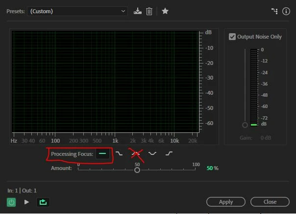

Upon closer inspection, it looks as though the effect is only acting on the 6kHz - 12kHz range. When I applied it to a file with a nice clean, even background noise (the kind of thing that is usually perfect for noise reduction), I got a perfect rectangle in that range on the spectral frequency display.
I'm trying to think of why the effect would restrict itself to a band like that. I haven't messed with any settings recently. Am I missing something?
SteveG_AudioMasters_
Feb 10, 2021 7:03 PM UTC
Here's a clue:
