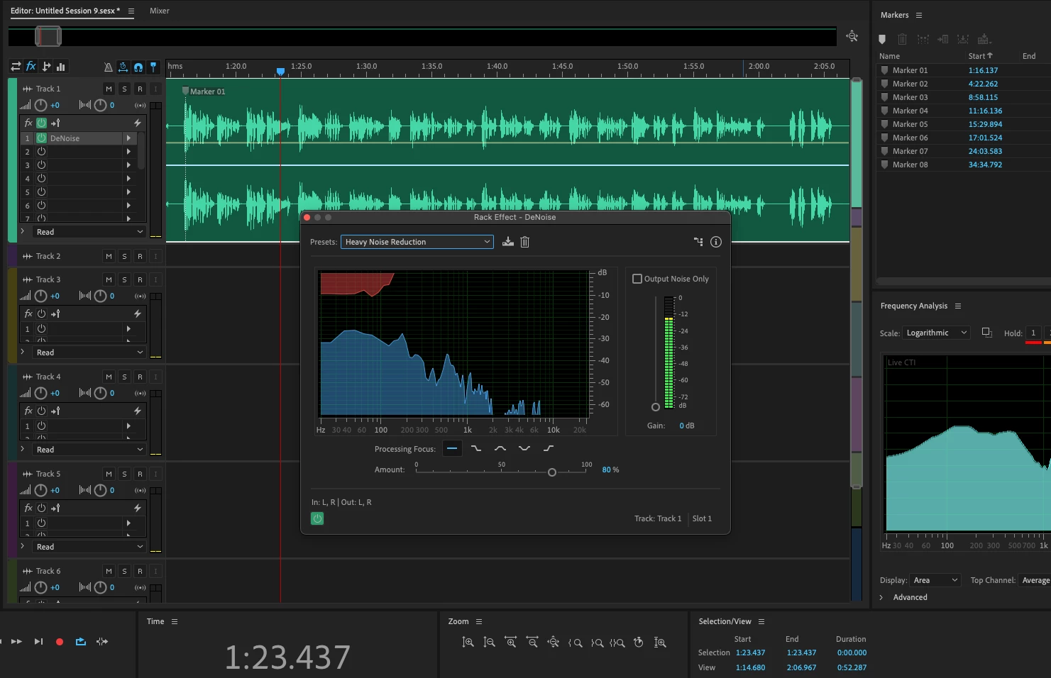

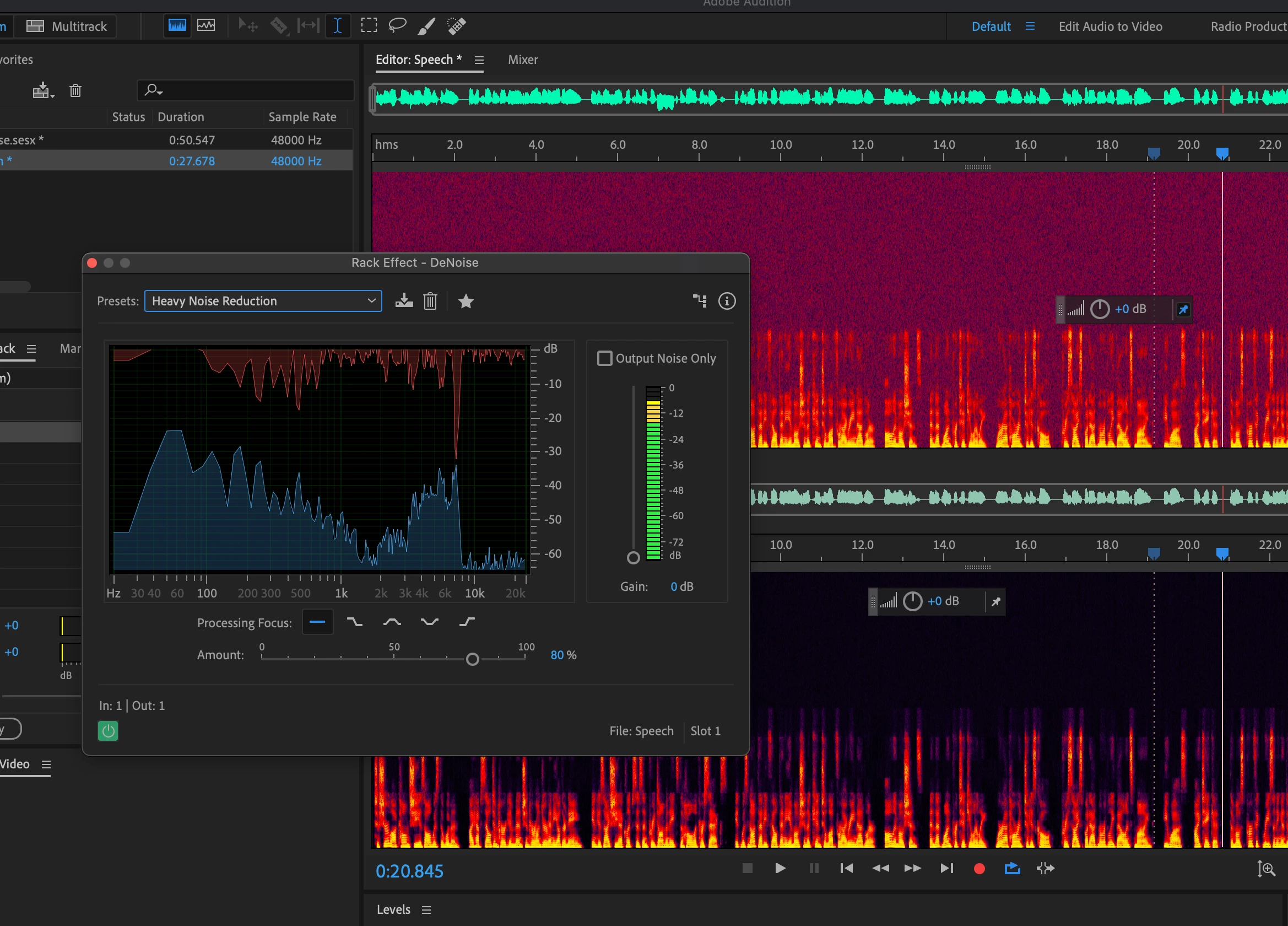

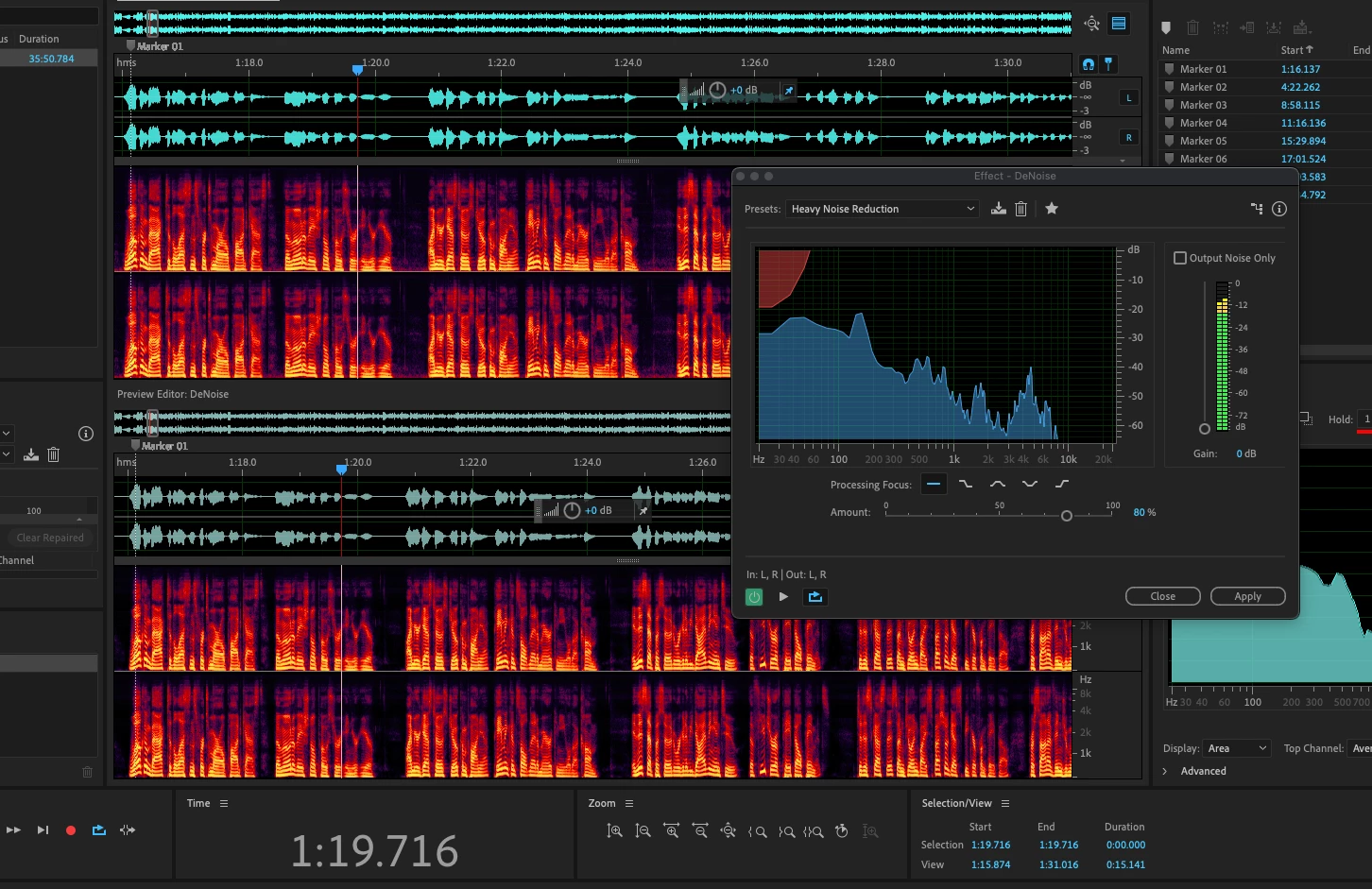

Hey Paul,
I was experiencing this issue in the Waveform editor, and yes with the DeNoise Effect.
In the preview editor, with Spectral Frequency Display enabled, it seems to show that the effect is applied but listening back in my headphones, the effect sounds like it hasn't been applied at all. (See Below)
I've also tried applying the same DeNoise effect in the Multi-track window and I get the same result. (See Below)
I also tried deleting the application and redownloading the same version, but I got the same results. I have recently been using the Beta version, and I have to say that it is the best version of Audition I've ever used, so I have a workaround I've been doing.
Let me know if you have any more tricks I can try, or if I need to clarify any I said above.
