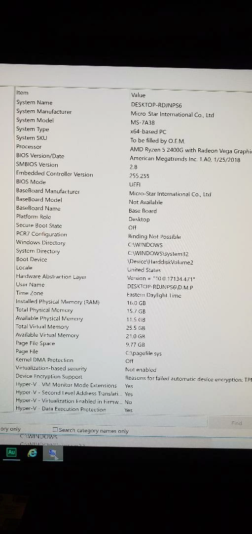

    so im STILL having this issue and just cannot figure out why. I even get it sometimes while mixing with the buffer size set at 2048. ive for months also been having problems with audition crashing...like ALOT. ESPECIALLY  when im in multitrack view, and im mixing. I would have music playing...then pause it so I can select a certain area..and then when I hit play audition crashes..this is VERY common. to the point that I try to be careful when I have everything paused and I hit play. its annoying because I pay monthly for this program and I feel like it shouldnt be as common as it is, does adobe keep track of the crash reports I send in???. but a bigger issue is the random audio cutting out during recording along with the dropped sample thing. I started recording at 256 and it seemed to help slightly before. but def doesn't now. my computer specs are in the picture at the top...what else can I do to find out whats wrong? its embarrassing for my studio to have audio completely cut out in the middle of an artist recording vocals.

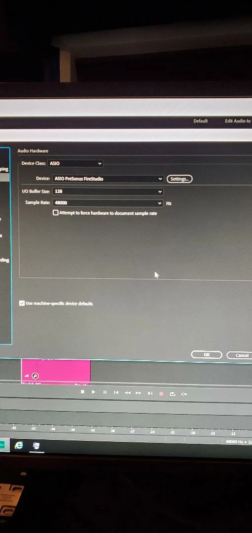

    You might also try increasing the I/O buffer size in Audition's Audio Hardware preferences.
