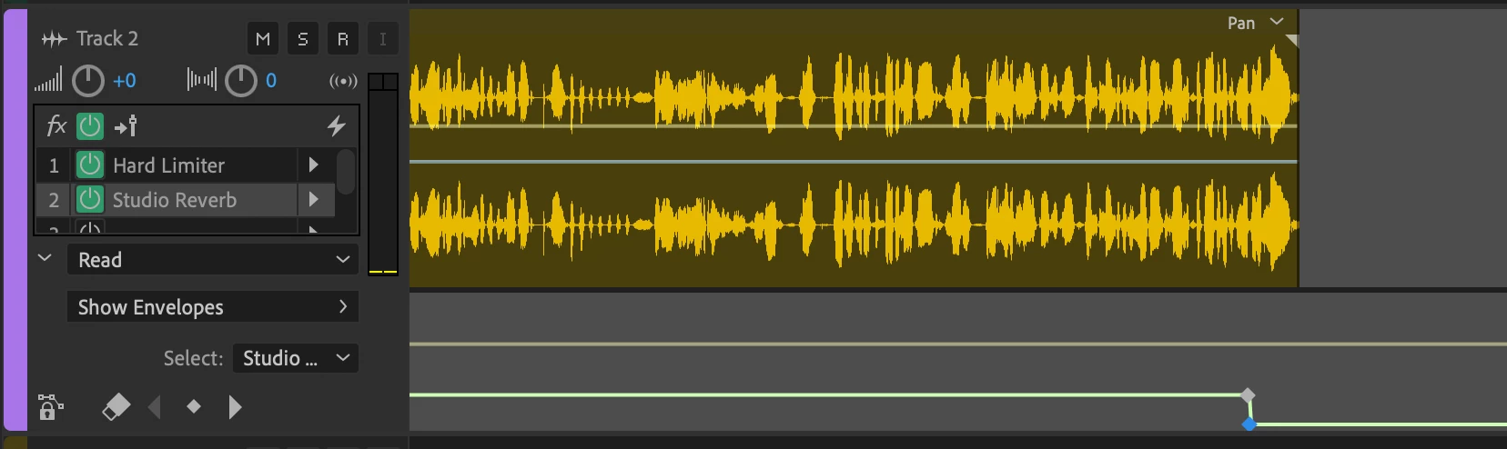

Since my last post, I found a third solution that I now use to fix this:
3. Use automation on the effect.  This is the one I use.  In the multitrack editor, show the envilope for the effect, and simply drop it off a second or two before the track ends.  (See screenshot.). This will put the effect on the entire track, other than the last second or so, so you don't get the mystry silence spilling over past the end of the track.
