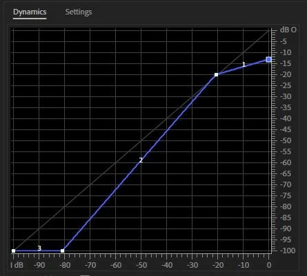

You probably just need to add one more point, as you won't be able to shift the LH point from the LH side of the screen - I can't find any setting that can't be reproduced pretty easily. But I should warn you - all audio is different, and what works fine for one file isn't necessarily going to give you anything like the same results on another one. And don't worry about setting to decimal points of a dB - the human ear can't detect these even on a steady tone, so they won't make any difference to anything; the nearest dB is more than good enough in the Dynamics Processor. Probably the most important thing though is to make sure you've normalized your file to 0dB before processing, as this is the level that all the controls in the processor reference, and without doing that, your results will be all over the place.

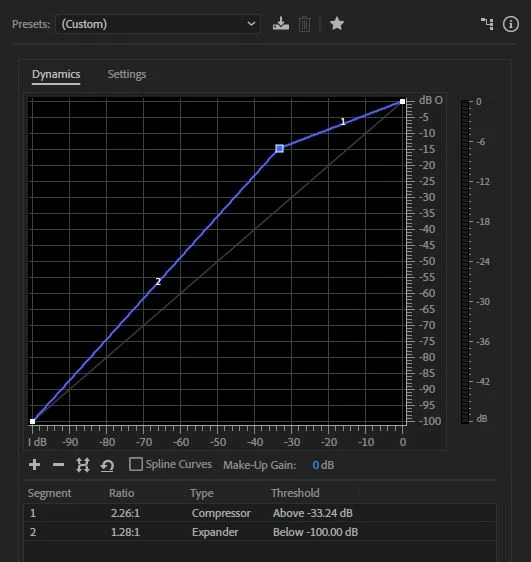

The way the dynamics processor front screen works hasn't ever changed - it's the same now as it was in Cool Edit Pro! I had a look at the only YT video about dynamics processing and voice-overs from four years ago that I could find, and yes, there is a way of achieving compression and expansion with a single point, but it doesn't involve moving the -100dB point at all:
Now, for one very simple reason, I don't like this very much. The problem with it is that the amount of compression and expansion are inextricably linked; you drag the threshold point about, and it seriously affects both slopes, and you can only alter the compression slope by bringing down the overall output level, because you can't move the -100dB one. Or add makeup gain, which will confuse you even more! Much better to use more points, and retain some independence between the slopes, I'd say. Also, using the Spline Curves option is a good idea; you avoid any sudden jumps in level at the threshold points. Once again, this is easier to set up with more points on the curve. HTH...
