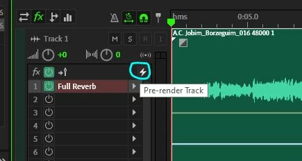

So having got that out of the way, let's look at what's likely to be the real reason, and almost certainly the way to prevent this happening. When you do a mixdown, a heck of a lot has to happen at once, and it's not that rare for the system to run out of steam - it's trying to process your mix at rather greater than normal playback speed, after all. Intensive processor effects, especially when they are being manipulated by the automation system, are known to take a bit of a hit when this happens. And that's why there is an option to pre-render tracks. By doing this, all of the intensive processing for a track is done in advance of the final mixdown, and it's what that little lightning bolt in the corner of the track/clip effects box, or on the track itself, is for.
If you change your mind, it's undo-able on a per track basis. Change what you want, and then re-render. Using this solves most mixdown problems and is definitely what you should try first.
