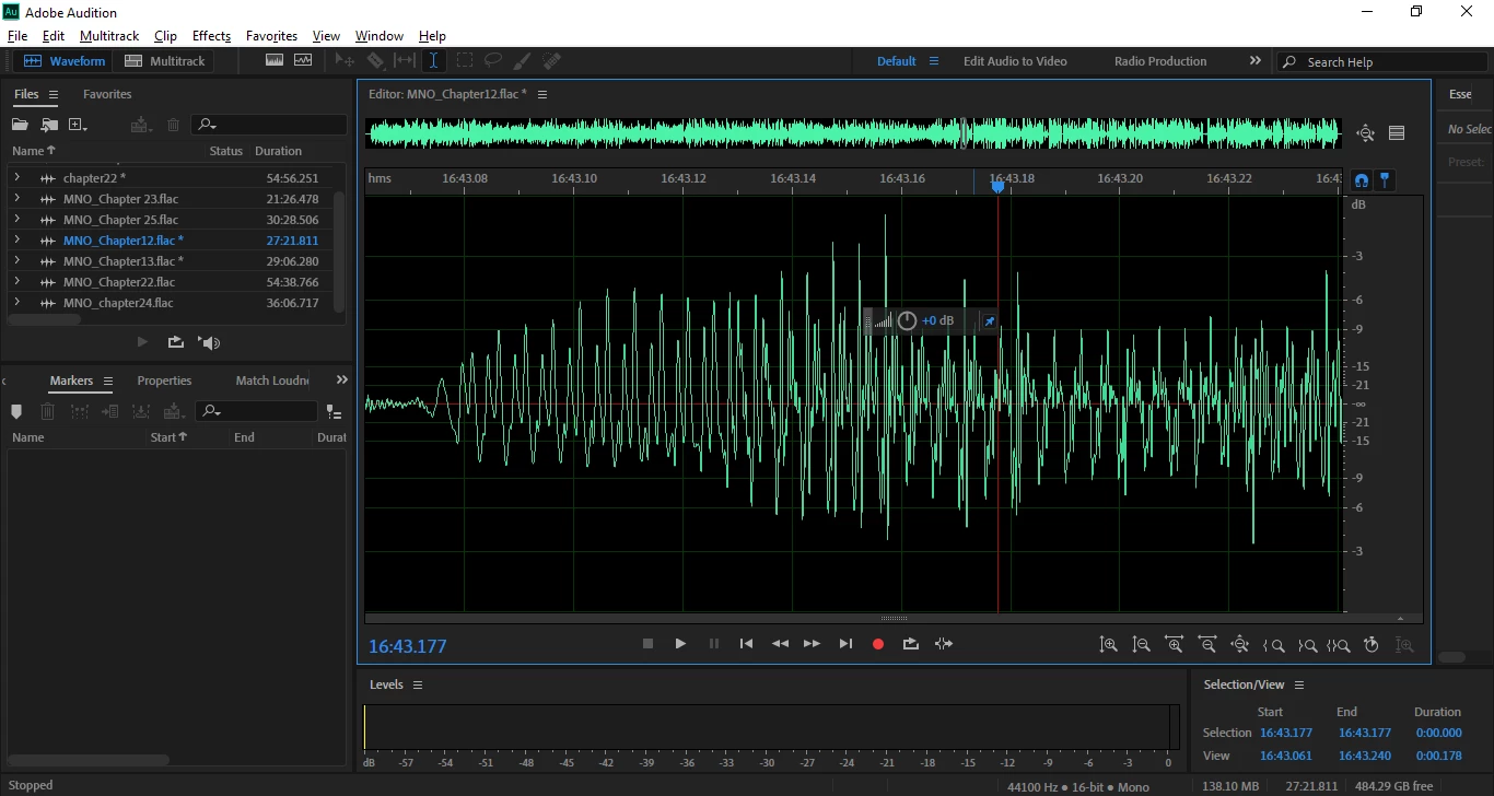

I am "mastering" an audio book and sometimes the narrator has these really scratchy/buzzy sounds that I can't get rid of.  I'm new to Audition, but I figured out how to highlight the problem and run it through the click/pop eliminator.  This works about 30% of the time.  I thought it was a spike in volume, but it isn't.  When I zoom in and look at the vocal curve, you can see that it's not smooth but very jagged.  Is there a way to fix this?  Here is a screen shot of a section that has been run through the pop eliminator but is still making that scratch sound.  Any advice would be so helpful!

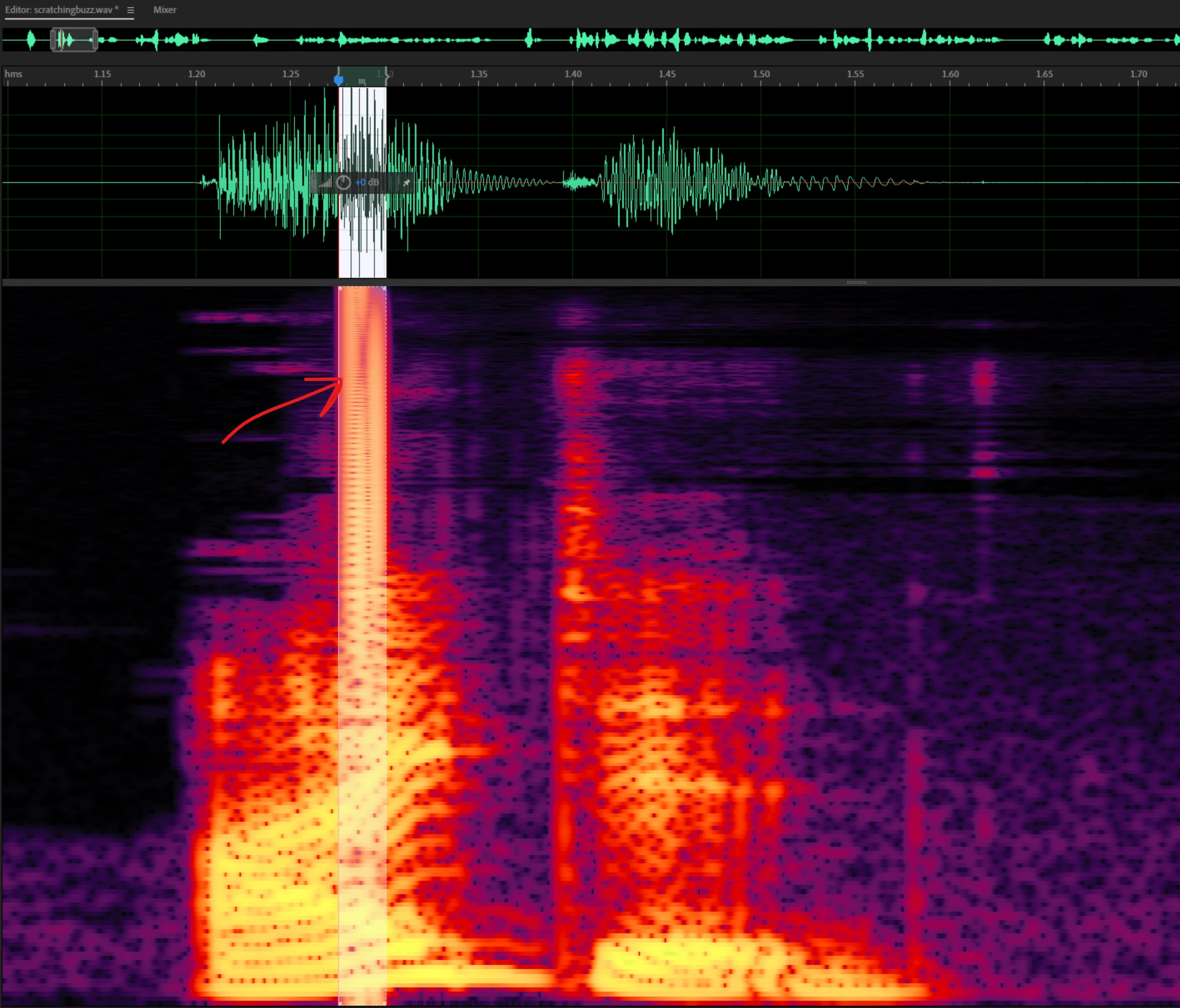

It sounds like you have some digital clipping here. This can be fixed in the future by turning the volume level of the mic input down while recording or, even better, running the microphone through a preamp with a compressor/limiter to stop these distoreted peaks.
I tested Window > Diagnostics > DeClipper (which would be the best effect for this) but it had little impact. The alternative is to run through the audio and clip out all these peaks. You can do it easily as long as you make a clean cut otherwise it'll sound edited. Switch on spectral frequency display and you'll be able to see all these clips as bright yellow lines.
I attached my attempt at removing the clips to show that it is possible 🙂

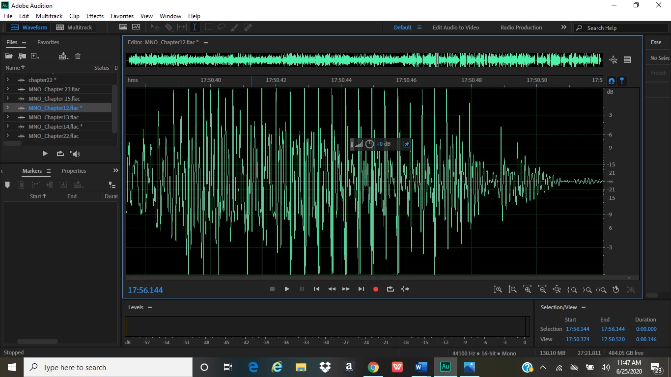

Jun 25, 2020 6:49 PM UTC
Oh my gosh, thank you for replying!!!!  Okay, here is a screen shot of several of these buzzy/scratchy bits and another shot of one of those bits zoomed in.  The part I can't figure out is even if I go in and individually delete the spikes, the scratchiness and buzz is still in there, like it's not even a volume thing.  Sorry for my lack of Audition vernacular, I'm new to this product.  Thank you so much for your help!!!
