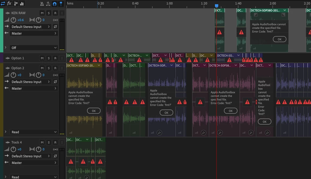

I uploaded a wav file to a session and built edits from that track. Now I have a few different tracks with various arrangements from the original file and when I go to save I get an error.
  • First it gives me the usual "The session contains 1 file with unsaved changes. Would you like to save changes to [file]?" and when I hit yes...
  • I am then met with the ensuing "compressed (lossy) format" alert. And when I select yes to that...
  • I then get "Apple AudioToolbox cannot create the specified file" Error code: 'fmt?'
And because the whole thing is built off this track (Monday brain mistake) I now have alerts on every single cut.
I'd really like to not have to redo this entire session. I have a few ideas for work arounds (exporting each track and going from there) but hoping there may be a quick fix on this... Any tips or tricks?

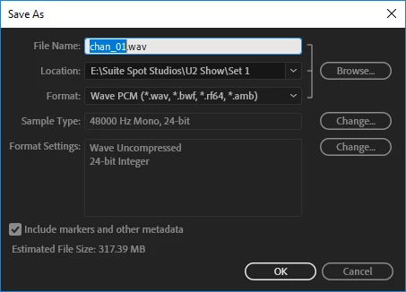

SuiteSpot
Jun 4, 2019 4:33 PM UTC
I'm also a bit confused
I'm happy to be corrected but as I understand it a standard RIFF wav file is a lossless format whereas MPEG layer 2 is a lossy audio compression format
Are you saving the file as WAV PCM or something else?
Where did the audio file originate?
