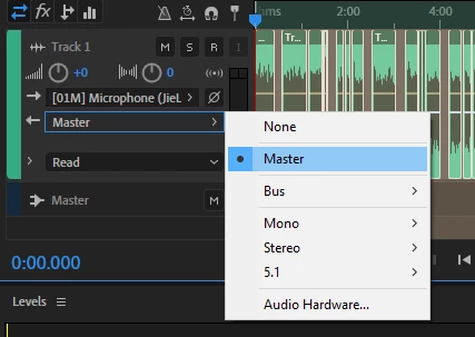

I don't know if anyone got the answer for this but I have it! You need to make sure that the selected output of your tracks is going to "Master",  otherwise there is no sound for audition to bounce!

I had the same problem and the source of the problem was that on the side of each tracks you can put in entrance a microphone and for the "out" part it's important to put "master" or "none" because if you put something else it wont be export.
I hope you urnderstand me, I can post a screenshot if you want
