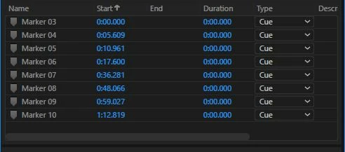

Exporting WAV file into separate files
I made a concert recording and have one large WAV file that I've added CD Track markers to and want to export the one large WAV file to separate WAV files. In the markers section when I highlight one or all of the markers, the button that says "export audio of selected range markers to separate files" is gray and nothing happens when I click it. I can't figure out how to take my WAV file and export as the 21 different tracks I've marked.

    You need markers between all the tracks, and also one at the start and finish.

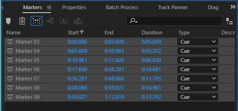

    You will notice that at this stage, none of the cues have a duration. What you do now is to highlight all the cues, and hit the 'merge' button (it has a blue square around it in the next screengrab):
    You will now notice that the cues all have durations, and that the handles look a little different. If you give each cue an appropriate name and highlight them all again, you can batch-save them to individual files with those names. That's the button two to the right of the 'merge' button.

    Aug 7, 2017 9:40 AM UTC
    In order to be able to save as separate files the Markers need to be merged into Ranges. Then the Export option will be un-grayed. To Merge the Markers make sure you have one at the very beginning and end of the file as well as the intermediate ones. Then in the Markers list select all the Markers and merge using the comb like icon (third from left).
