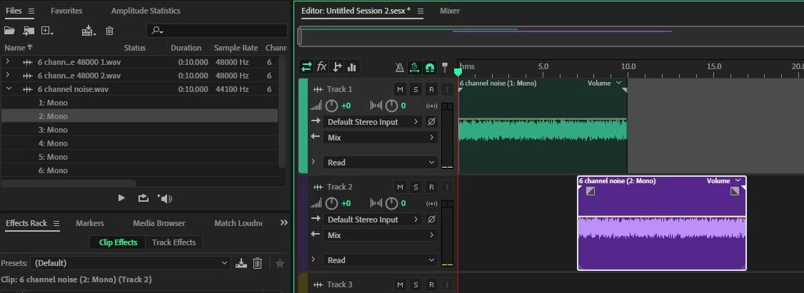

Edit>Extract Channels to Mono Files, but only in Waveform view. If you import a multichannel file into Multitrack, and use the twirldown, you will see each channel separately, and that gives you quite a bit of flexibility...
You can shove the contents all over the place like this. (The file shown is just for demonstration putposes)

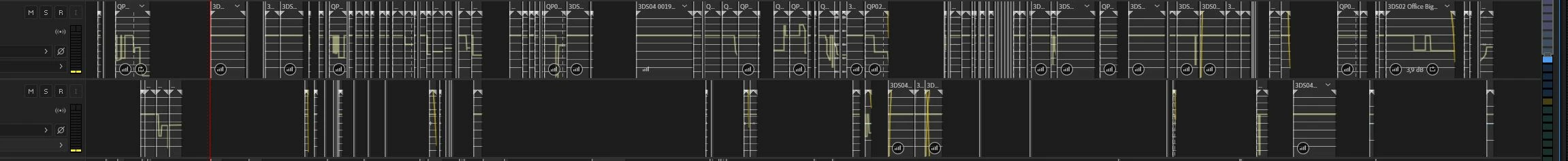

Hi Steve, thanks for your reply. However, since i'm doing a 5.1 mix, the poly files are containing multidirectional recordings. I need to use all of the tracks separately panned to separate channels.
See picture. In these tracks i have hundreds of poly files, containing all 5 separate mono tracks. Is there a way to extract these?
