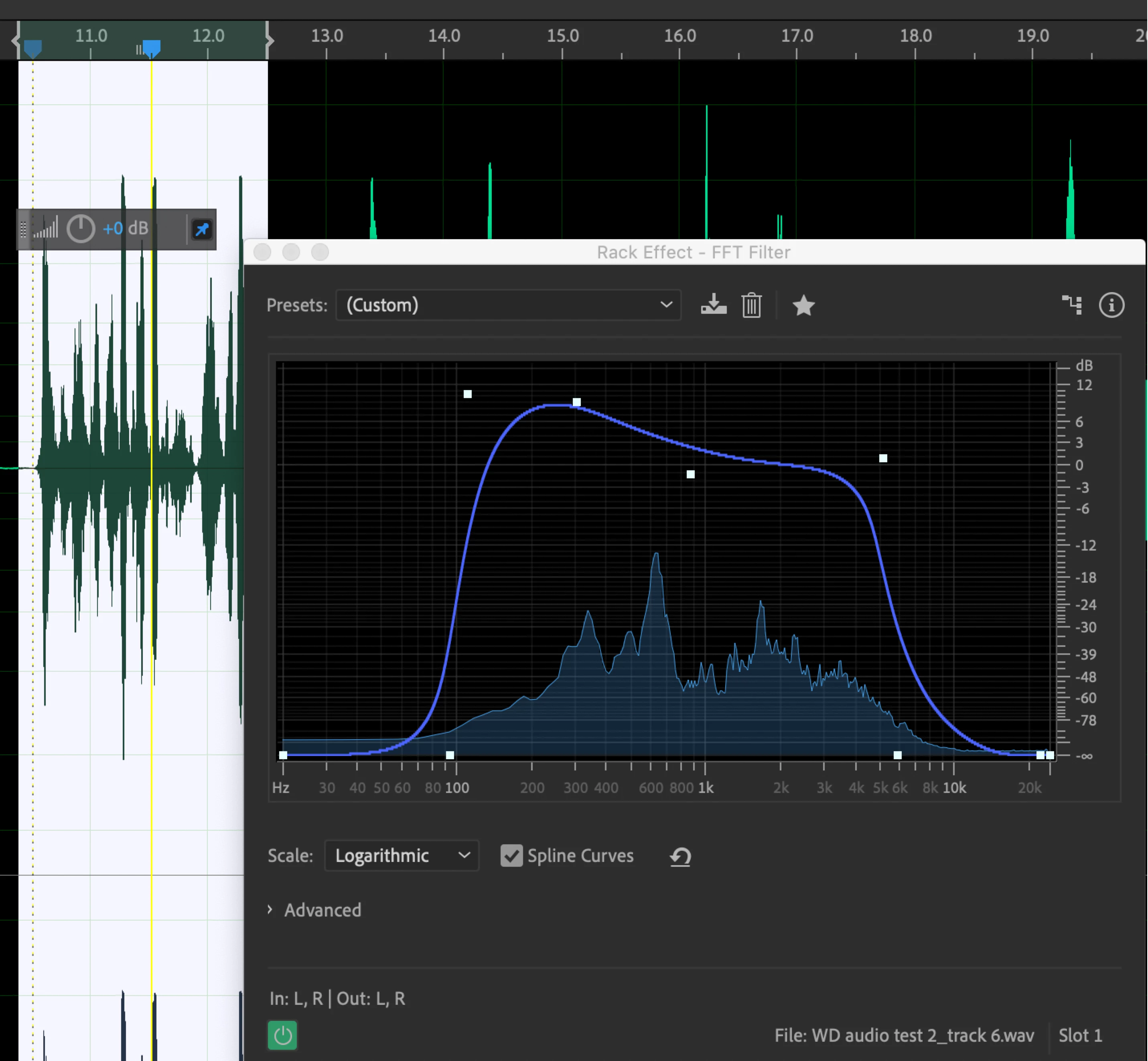

EuanWilliamson
Jun 17, 2021 8:42 AM UTC
Hi Andrew,
I'm not sure of course what you've tried.
I had a look and listen to the file an used the frequency analysis on a section.
It shows a general lack of presence in the bass frequencies.
This analysis was of the section highlighted in the next pic.
A correction made with the FFT filter ( or you could use the parametic equaliser ) boosts the bass frequencies
to counteract the lack in the recording. Perhaps combined with your other "fixes" this may help.
Of course as you say, you have many variations of many mics so it's not possible to find one solution that fits all 😞
Best regards, Euan.
