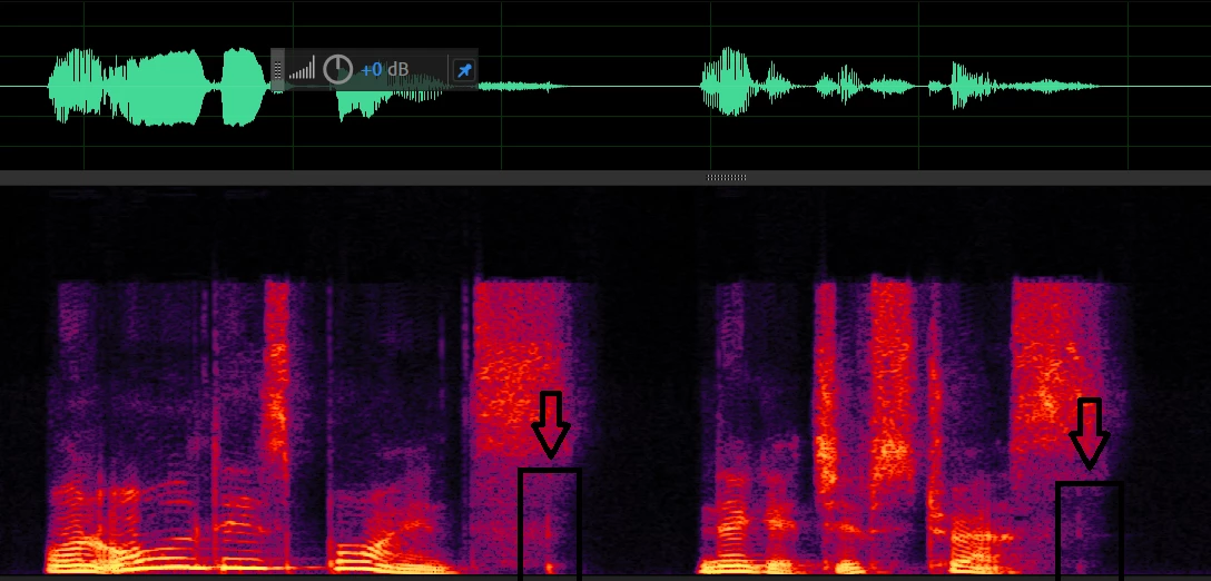

I have adobe audition and rx elements. i have a clicky mouth and at the end of many words i cant control a mouthclick, i havent found yet a tool to get rid of them i tried declick of adobe audition and rx declick but it doesnt work. I do it in the adobe audition spectrofrequency manually with the brush but it takes times as it is large audios. i would like to know if there is a solution to industrialise the  process.
here is a sample of the audio and the spectrofrequency view

The recommendation for using this mic is to get 4 or 5 inches away from it, and not directly on axis with it - this alone will improve the clarity. And also use a pop shield.
The other thing you could try is Adobe's Speech enhancer.  This can produce some quite interesting results, and generally they are better.
