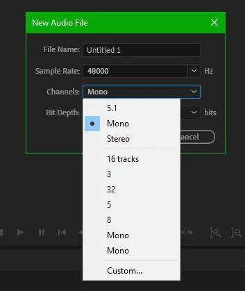

Waveform doesn't work fine though, it only records in my right ear, can't seem to find how to set it to mono. Unless it's meant to do that?

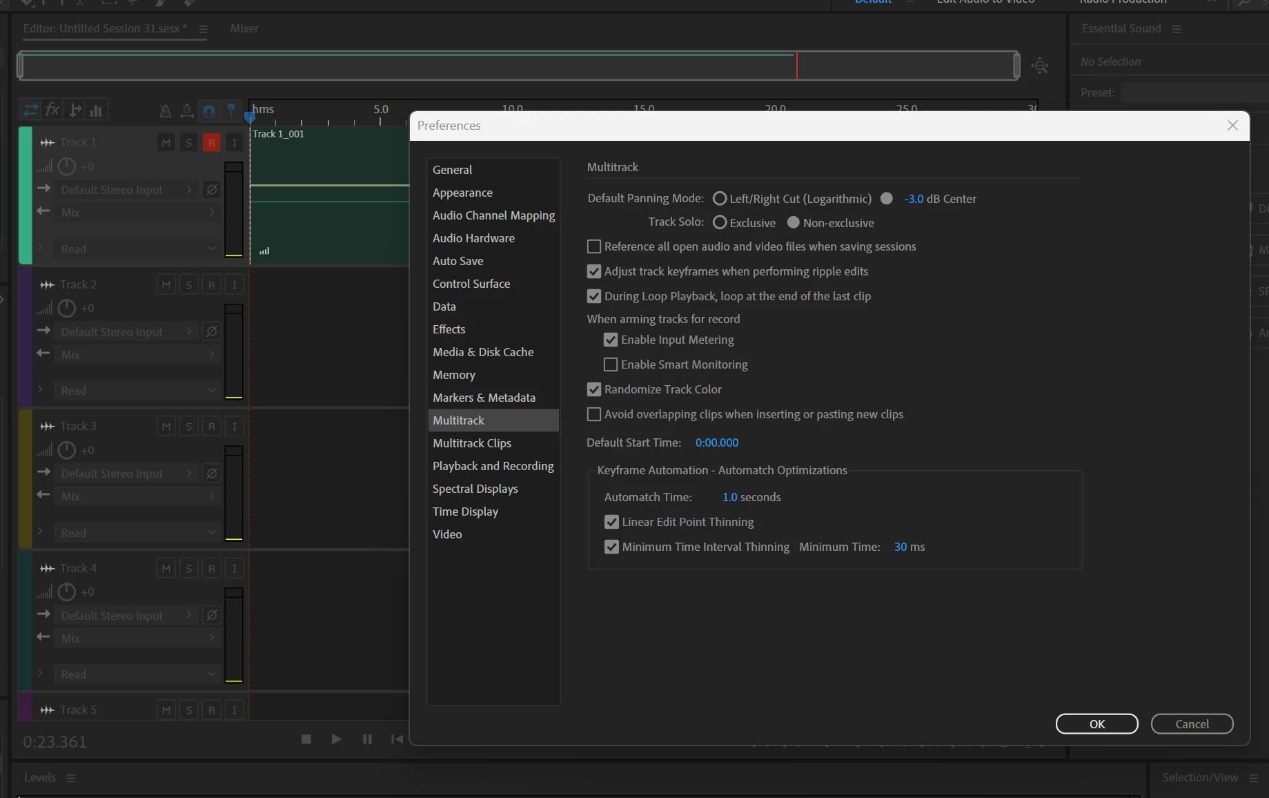

Here's my Multitrack settings though. I'm not sure which window you need specifically so here's all of these
Audition always does as it's told. When you start a Waveform view recording you get some choices:
If you pick stereo, and you've only got a guitar plugged into input 1 (or 2), then yes, all you will get is a recording on either the left or the right.

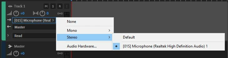

In Multitrack it's different. You have to decide whether it's a stereo or mono track you are recording into, and then make sure that the input is set appropriately:
And again, if you set it so that there's only a single input to a stereo track, that's what you get; just one channel, and this is what you need to check carefully, as it sounds as though you've been recording the preamp noise from the 'other' input rather than the guitar.

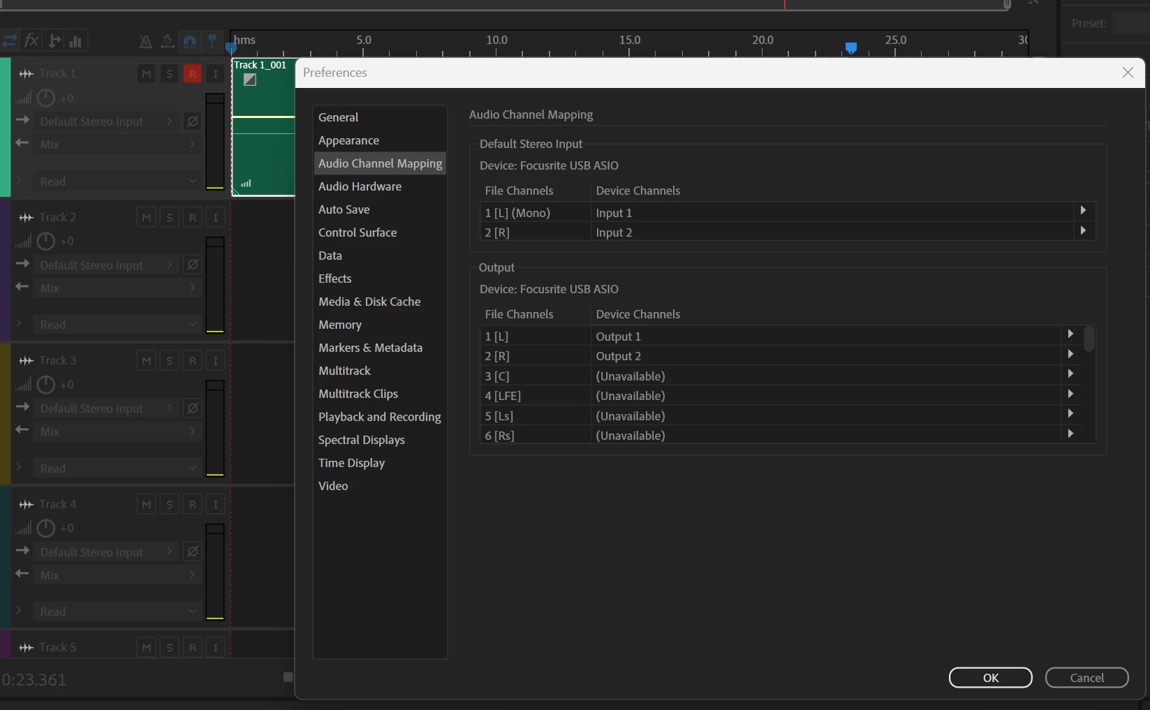

In the list of things you've done, I haven't seen any reference to an input check. If you try recording in Waveform view, does the same thing happen? (I'd use the ASIO driver for the moment) If you are using the input set to 'default', have you checked to see what the default setting actually is? (Edit>Preferences>Audio Channel Mapping.)
Jan 16, 2023 2:31 AM UTC
Oh, yeah seems to work fine in waveview, but it's all only in my right ear
And here's what the Audio Channel Mapping window looks like:
