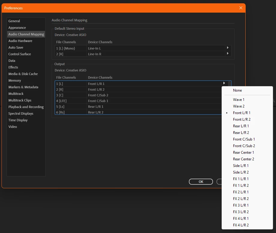

Hello, I have a question for you. I have a SoundBlaster Audigy RX 5 sound card with SPDIF output and now I am wondering if I can somehow force a Dolby Digital signal from my computer. My amplifier uses Dolby Pro Logic every time I work with 5.1 in Adobe Audition 2023 even thought I am trying to mix Dolby Digital and I am sending all the channels it needs.
My current channel mapping in Audition:
Dolby Digital is working fine when I play music that I mastered and exported as AC3 from Audition the thing is I don't get Dolby Digital straight from Audition when I am trying to master 5.1 it only works in Dolby Pro Logic so when I am listening to center channel in Audition, I cannot hear anything from my speaker also when I start playing music from channel left and right it suddenly starts playing on center channel because of Dolby Pro Logic. I don't know how to explain it. Maybe Audition is just too basic to always output 5.1 sound in DD. If I am trying to master 5.1 it's really hard when the software that I use is not outputting Dolby Digital signal.

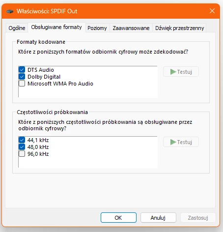

This is my current audio card configuration:

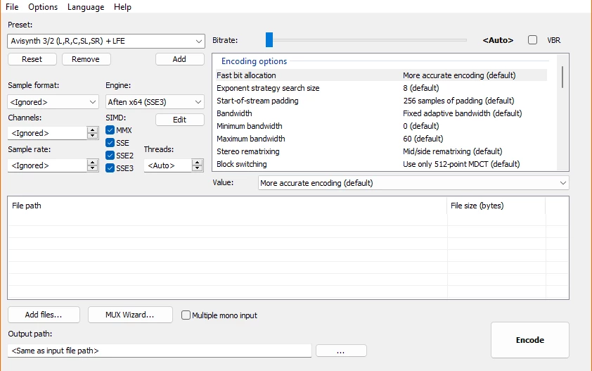

I exported the WAV file with all 6 channels encoded (i think) then I used an open source converter that converts WAV to AC3 file format and the Dolby Digital actually works I am getting proper DD signal, It even works on my good old Technics SA-DX940 all channels are present and working
