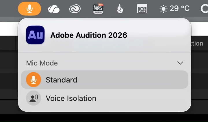

    Jun 29, 2026 6:04 PM UTC
    Make sure this mode is not “Voice Isolation”. (This is a “helpful” Mac OS thing.)
