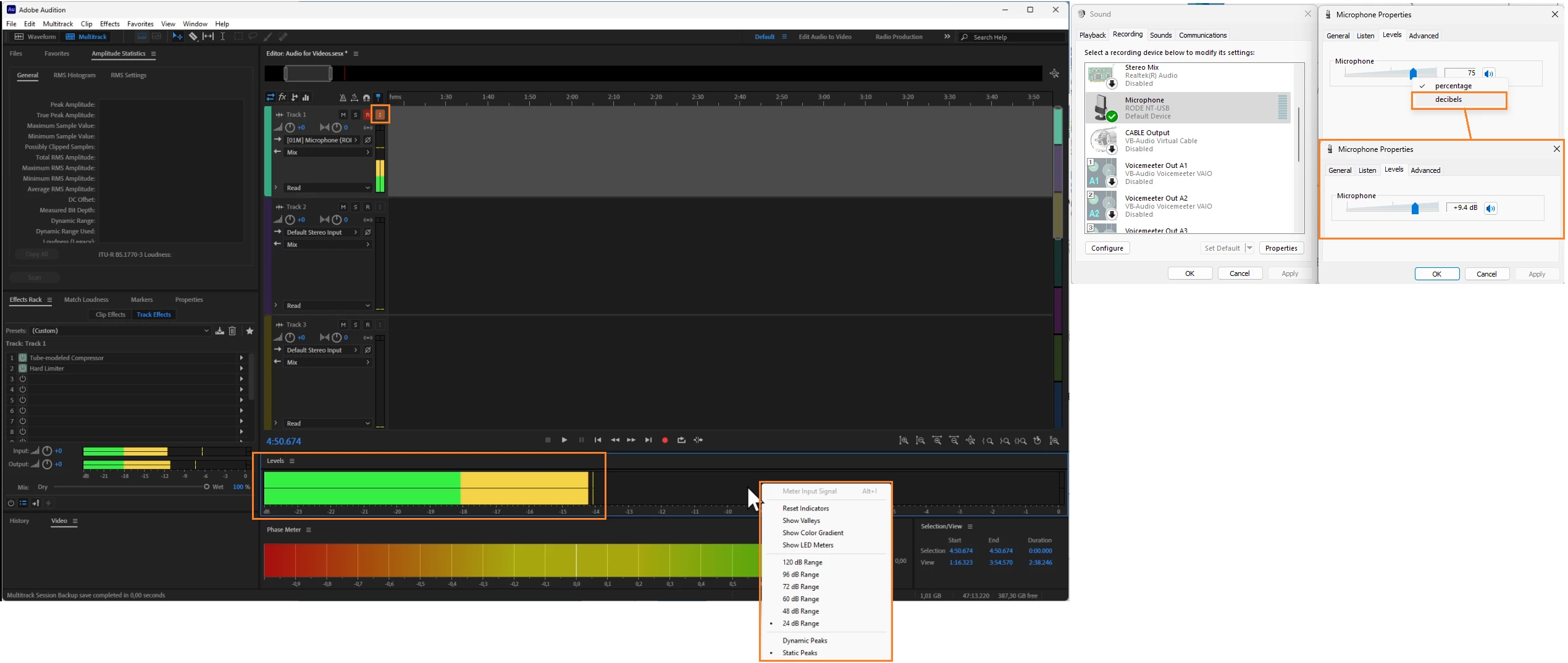

I am attaching an image which illustrates how the mic is setup in windows (I have my headphones connected through the 3.5mm jack on the RØDE NT-USB) and a recording comparison I did of my setup vs what the great Mike Russell showed in the video below

Sorry I don't fully understand the concept of setting the gain headroom to allow louder audio between 12-15dB lower than the 0dB peak. I usually set the gain so that the audio sounds loud enough and does not have so much gain that the audio sounds distorted and that is pretty much all I know to be honest. And in terms of setting the levels in Windows sould I be using percentage (e.g. 75) or decibels? See screenshot below.
And also I don't understand where in the Audition UX the monitor input levels facility you refer to is located.
The thing to do is to adjust the levels using the 'monitor input levels' facility in Audition (right-click with the mouse held over the meters and you'll get that) and set it so that your recorded peaks are around -12 to -15dB, as noted above.
If I enable recording (R) and input monitoring (I) then the Levels panel below becomes active but I don't like using the input monitoring as there is always a delay between the input and output. Is this what you are referring to, as shown in the screenshot below? And how do I set it so that the recorded peaks are around -12 to -15dB?

Yes, use the I (Input) button - they disabled the right-click option, and I forgot... It's no good setting levels so that it 'sounds loud enough' - that means nothing. It's the level that is fed to Audition from the mic that is important, and you adjust the gain so that this level peaks at somewhere between -12 and -15dB on the meter. You don't have to keep monitoring it, you just set it for your level at the time, and Audition will then be recording a signal that isn't disappearing into system noise and interference, and with sufficient level to show in multitrack. Setting that input level is important. You've got to get this right first before you can sort out everything else. The record input level is the only one you care about - all the others are just listening levels, and don't relate to your recording at all.
