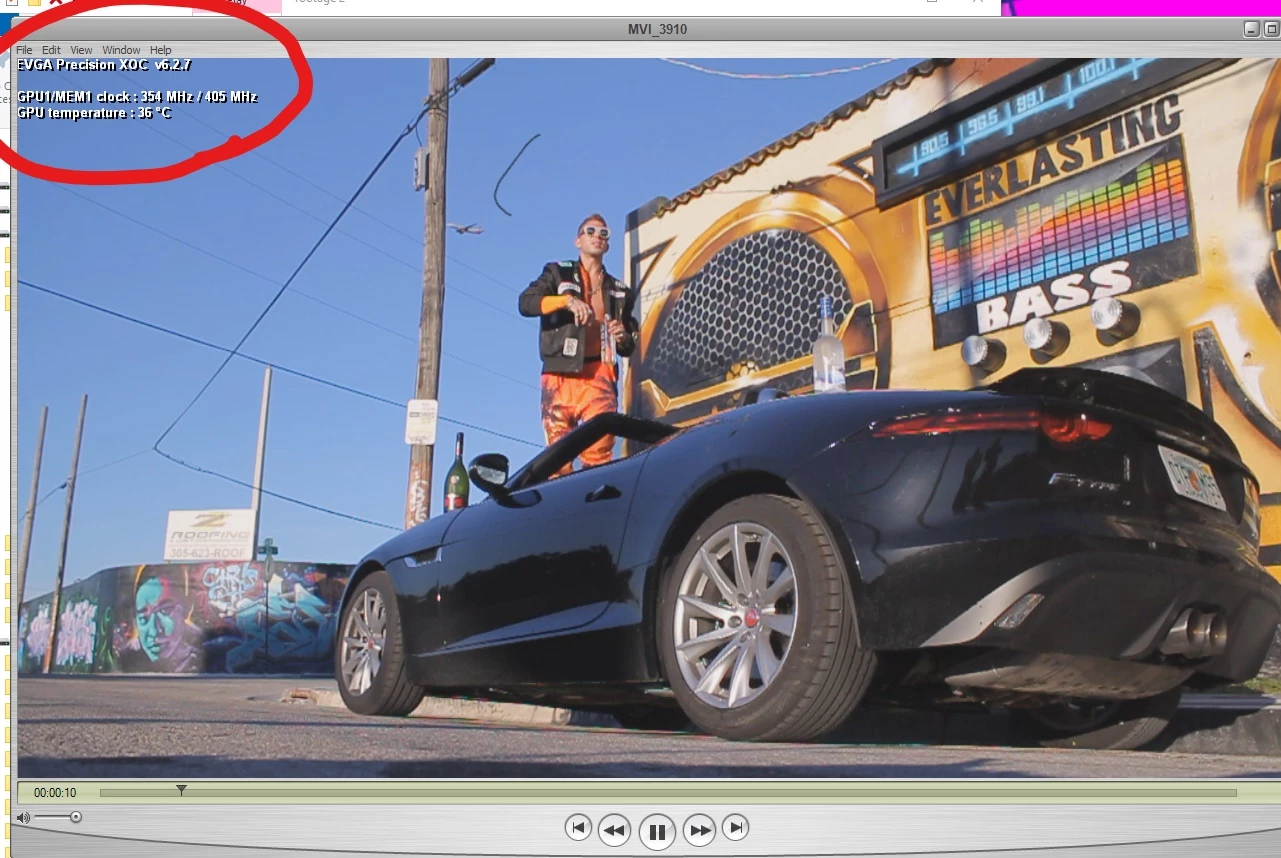

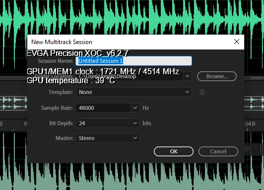

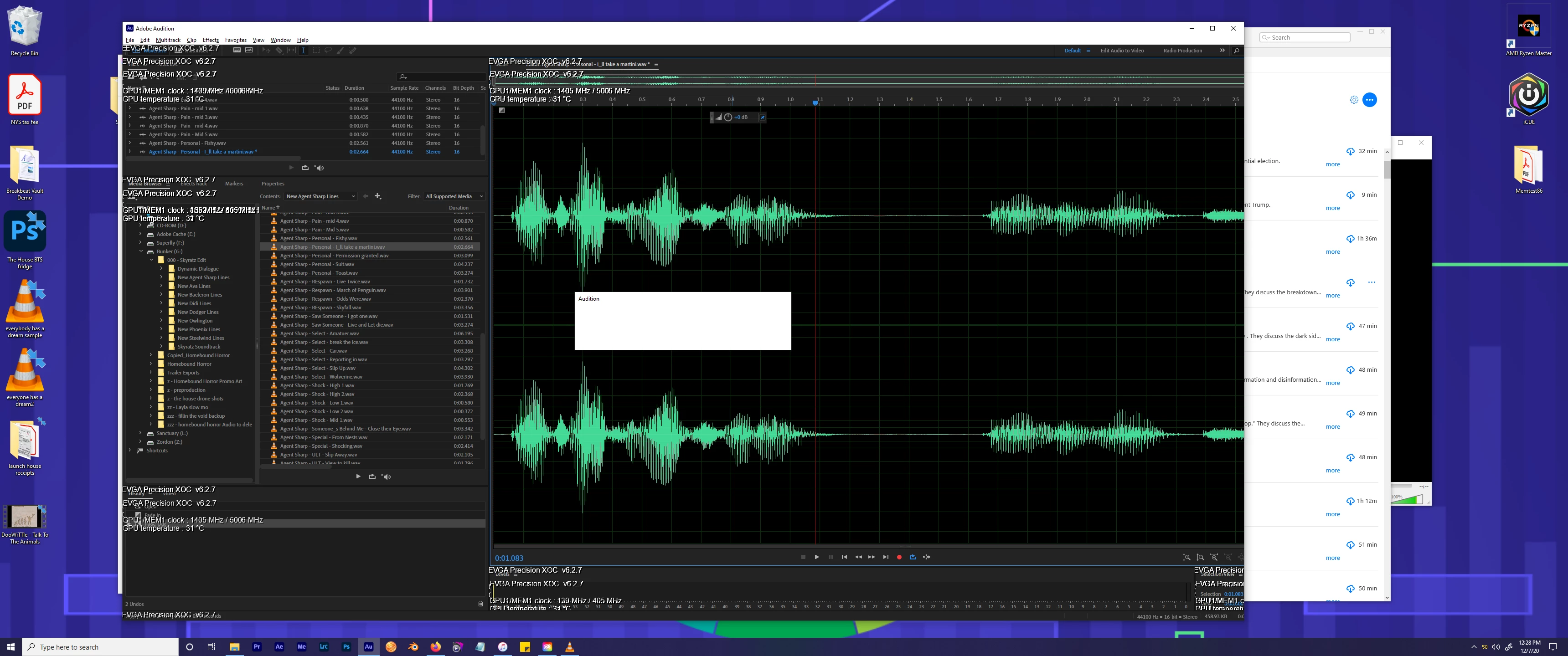

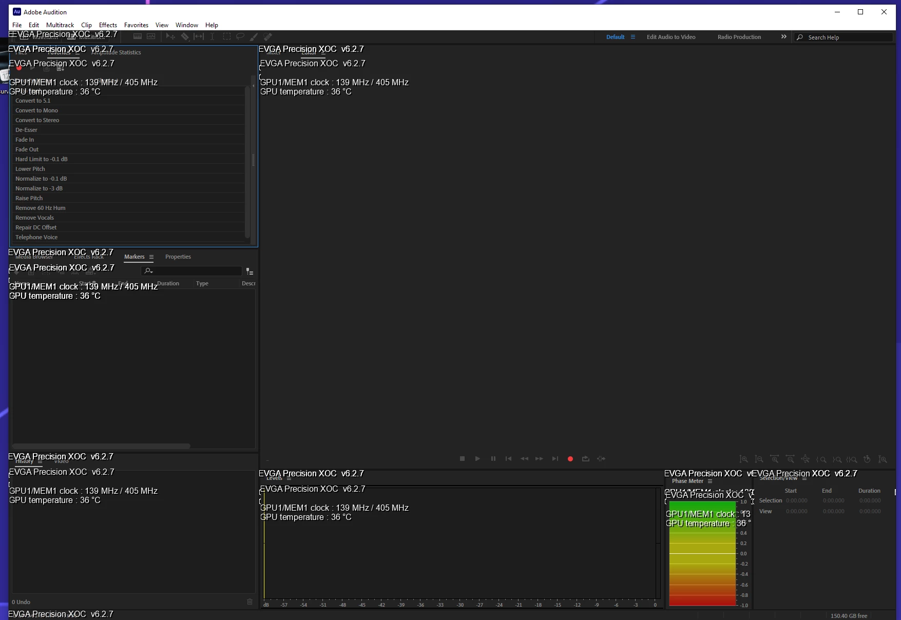

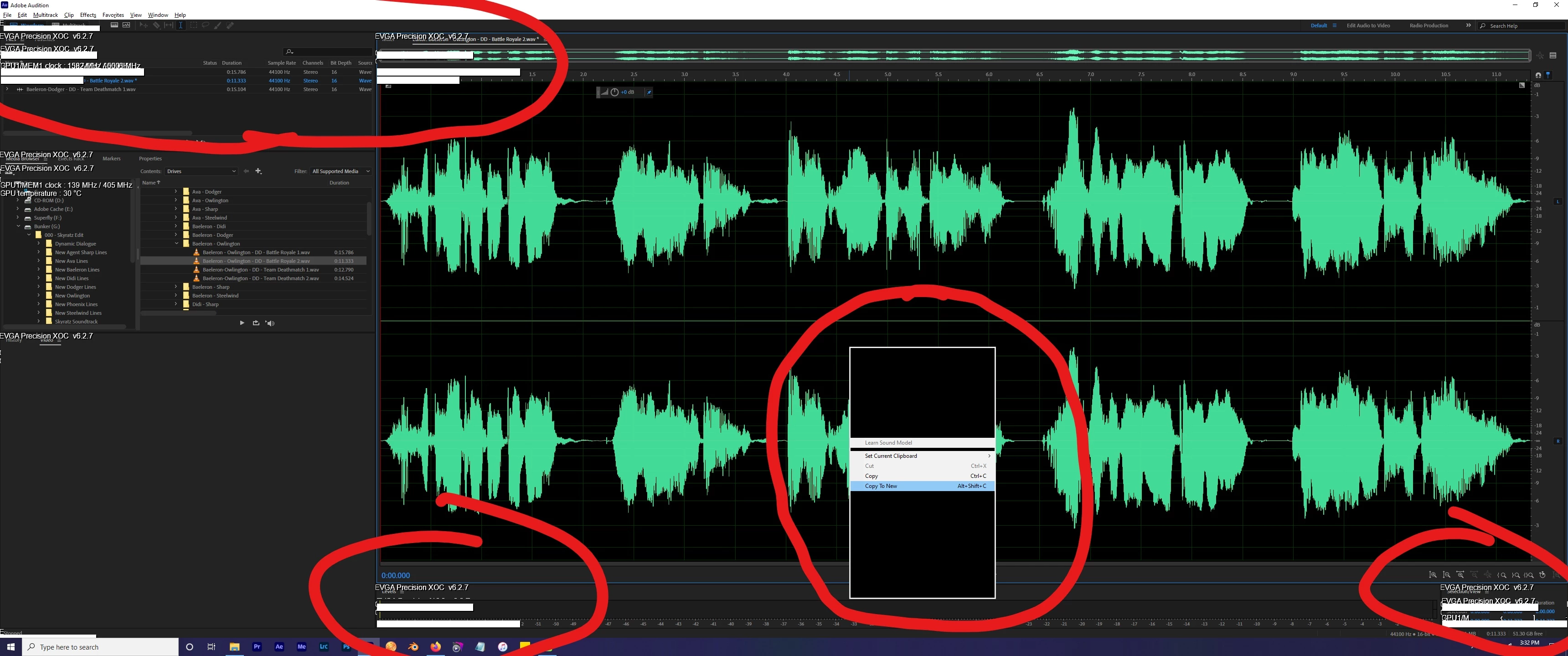

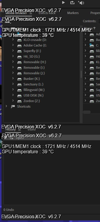

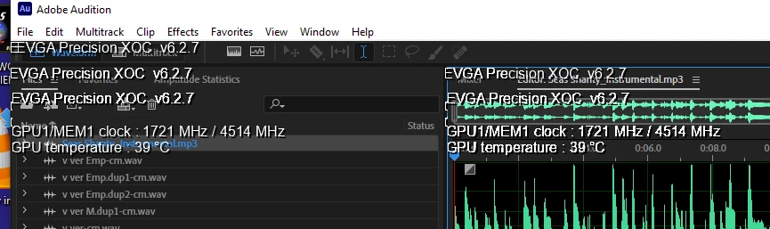

I've been having odd issues with Audition where every panel will have my GPU information overlayed on it (see picture attachments). This makes it very difficult to work around. Also, I get approximately 5 minutes in the program before it freezes and I have to force quite. The program freezing happens gradually. First a couple glitches, and then the text in the UI will start to disappear, and then it will all out freeze.
*side note - This same overlay issue used to happen in After Effects when I'd use Video Copilot's FX Console panel but it's stopped doing it recently. I also noticed appearing on Quicktime player. However, I never experience any of it with Premiere, Photoshop, Lightroom or Media Encoder

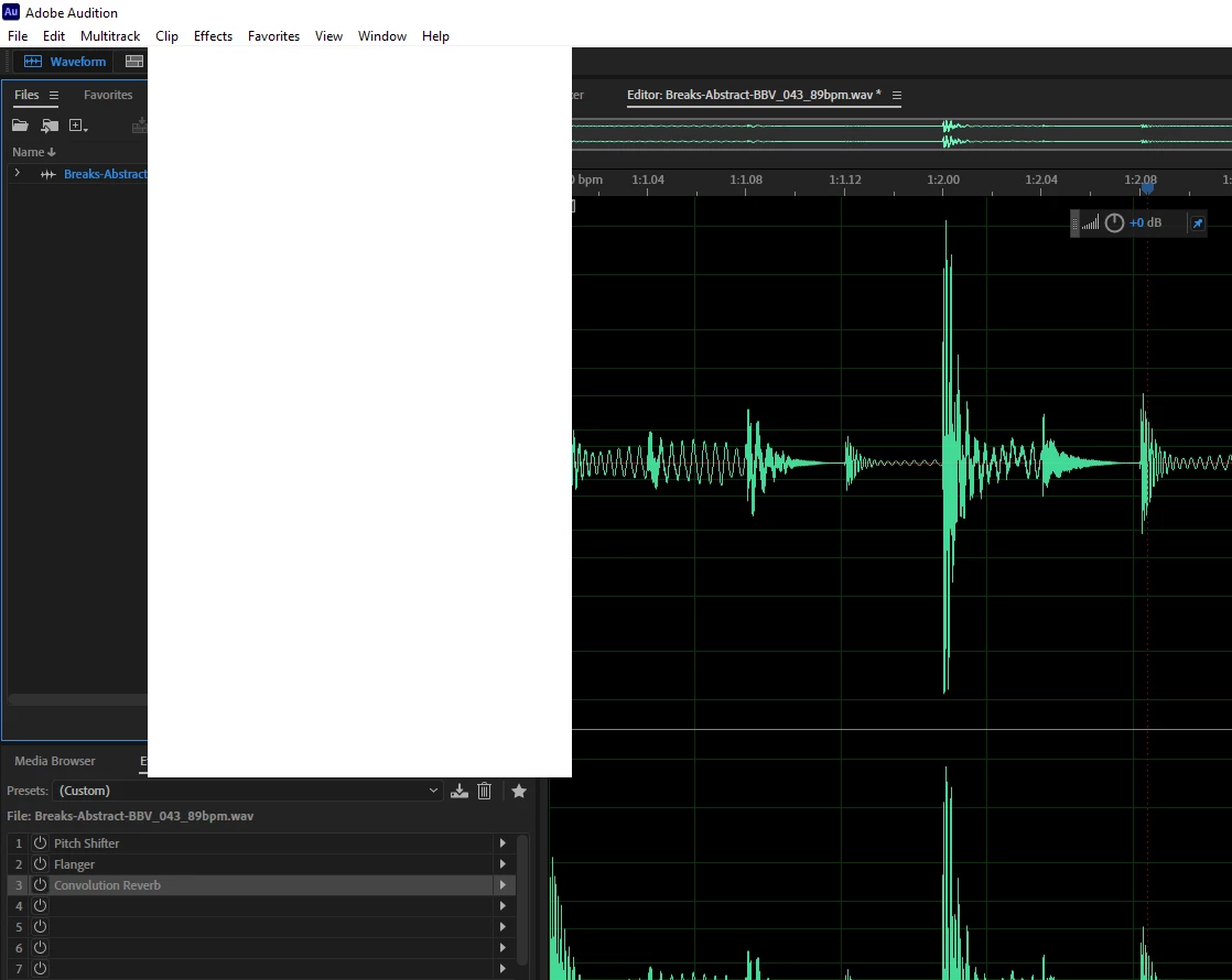

*update

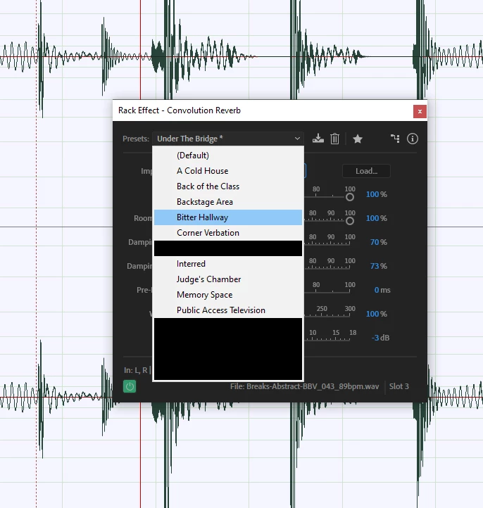

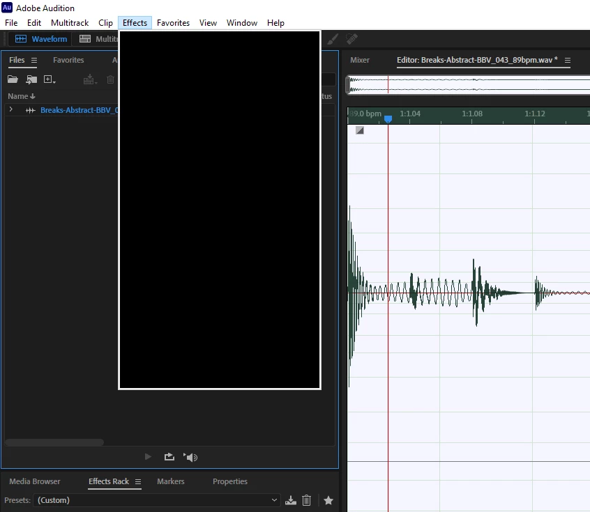

So I was able to get the GPU overlays to go away. I did this by opening up my EVGA precision XOC software tool and disabling the OSD (on screen display). However, Audition is still doing the same freezing sequence (program works for about 5-10min and then things in the UI start getting glitchy (see attached screenshots) until it eventually crashes.

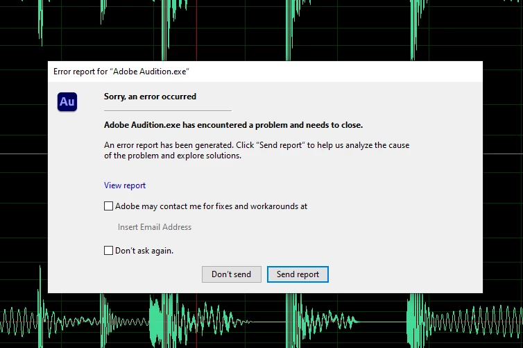

Feb 19, 2021 10:17 PM UTC
Yes it seems Audition and my GPU are really at odds. After making sure all of my drivers (and software) are up to date it's still freezing up with the same issues. I attached the most recent logs I have. Will send them to the email you recommended to too. Thanks!
