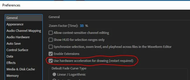

    One thing you might want to try in regard to this behaviour is changing the state of hardware acceleration. If it's on, switch it off, and vice versa - this can make a material difference to the way some systems behave.
