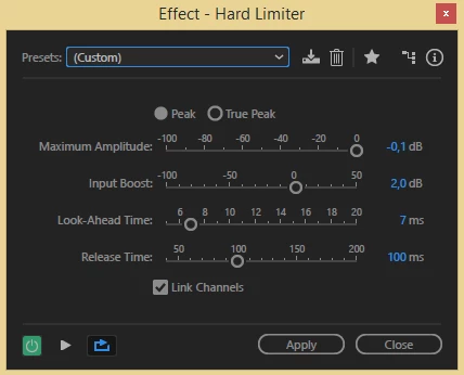

So was I doing today for another project, with the following settings:

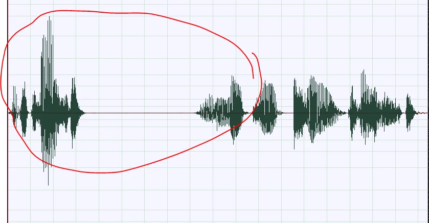

One single file after batch processing hard limiter with above settings:
Before:
So the frequencies in the beginning of the file suddenly disappeared.

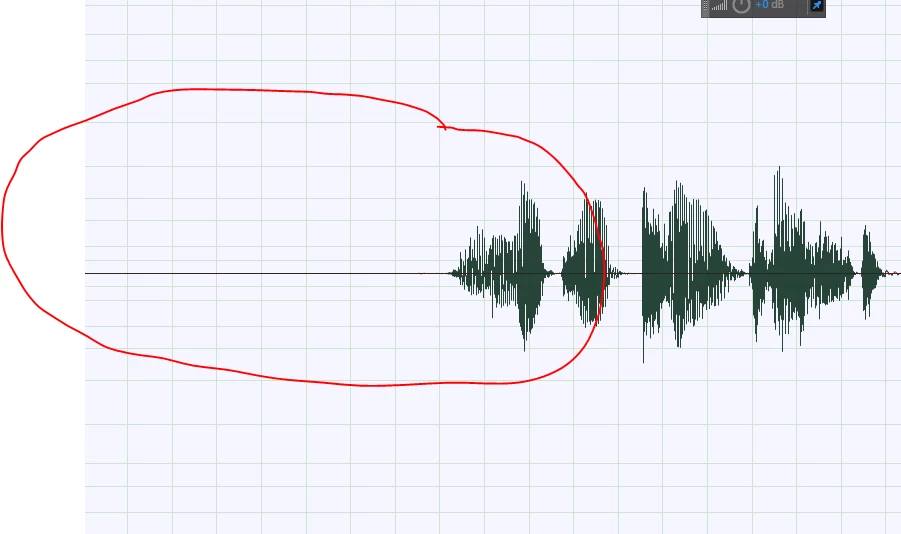

Same file with same hard limiter settings, but not in batch processing:
Correctly 2dB louder.
