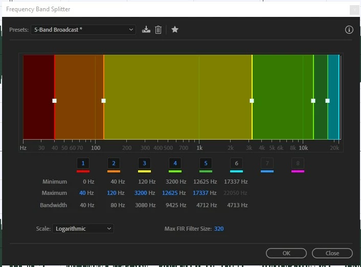

    May I ask the reason for wanting to split the audio into different frequency bands? Also did you realise that Audition has a built in audio frequency band splitter. However it is only available in the Waveform view. It is available under the Edit menu Frequency Band Splitter and can split the audio into up to eight different bands. You end up with as many separate new .wav files for each band selected.
