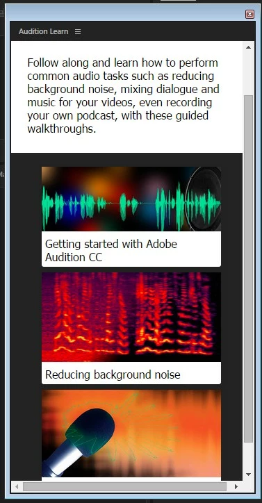

    If you are using the latest CC 2017 version of Audition try looking at the Audition Learn feature from the help menu. There is a tutorial there for doing Noise Reduction which goes through all the steps outlined by Steve in more detail.
