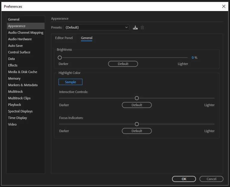

How can I change the color of the selected windows and some text in the workspace?
How can I change the color of the selected windows and some text in the workspace? Previously, according to 7.0.1.5, there was not this awful blue color that presses on the eyes. There was a soft shade of gold. Can I get it back?
    BarloGT_MoonSpearCorrect answer
    Apr 4, 2018 4:01 PM UTC
    Very sorry. I know these settings.
    IMHO. Change the color from warm colors to a cold, very strange solution. This neon blue begins to put pressure on the eyes for any long work, regardless of the tinctures. It's strange that there is no setting for changing this color (This is harmful for the eye muscles, for example, I only see one eye normally - the last version for me is 7.0.1.5. (CC 2014).
    UPD
    Through a long search on the forums, I found a solution to the problem .... which plunged me into extreme perplexity. Therefore, this is not brought into the usual settings, because the color setting is in the program !!
    If anyone needs -
    1) If the hotkey settings are changed, then temporarily return to the default option
    2) Press CMD + f12 (or Ctrl + f12 for Windows)
    3) Right-click the console icon and select Debug Database View
    4) Find Enable_Theme_Colorizing and select True (or put a daw)
    5) Everything, the ability to adjust the color of the window and the text of the former neonovo poisonous blue - appeared in the appearance settings

    Hi BarloGT,
    I do not think that is possible.
    You can make some adjustments with the brightness level under the Preferences.
    UPD
    If anyone needs -
