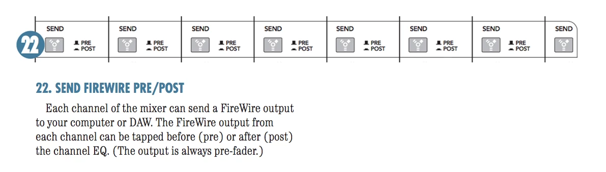

    Oct 11, 2017 1:21 PM UTC
    https://forums.adobe.com/people/Bob+Howes  wrote
    This is inherent in the 1620...the Firewire direct outputs are post gain/pre EQ (which is the most conventional way of working) and there's no switch to change this.
    The EQ stage on the Onyx mixer's channel strips are switchable (pre/post EQ). The Outputs are always pre-fader.
    -paul.
    Bob Howes
    Oct 11, 2017 10:36 PM UTC
    Thanks for that--the facility certainly wasn't there on earlier versions of the 1620.  I recall lots of frustrated posts on things like the Mackie forums and SoS.  They've obviously added it and that's why the mod I mentioned is no longer posted on the Mackie site.
