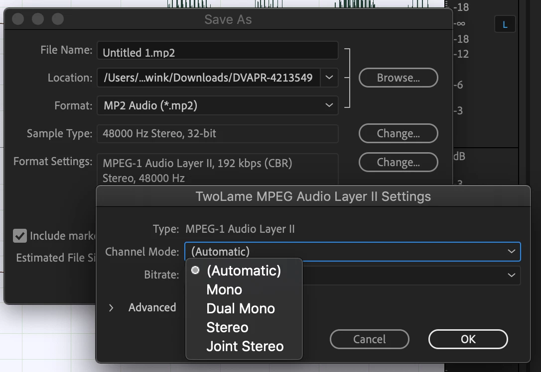

    Charles VW
    Jan 30, 2019 4:09 AM UTC
    Which codec are you trying to use? For MP2 exports, see screenshot:

    SteveG_AudioMasters_
    Jan 30, 2019 10:41 AM UTC
    The concept of 'joint stereo' only occurs with compressed (therefore encoded) files - can't happen with uncompressed files at all. For more info, this is pretty succinct: What is Joint Stereo? | Richard Farrar
    Jan 29, 2019 10:33 AM UTC
    The reason that you won't find that is that the concept of 'joint stereo' doesn't exist as such - all stereo is joint, by definition. It only comes in two forms - L/R or M/S.
    But you haven't given us enough information. Is the file you are starting with a single-channel mono file? If it is, you'll only be able to convert it to what the BBC refers to as 'glorious mono' - where the same information is in both channels, and it comes out centrally when played back on stereo equipment.
