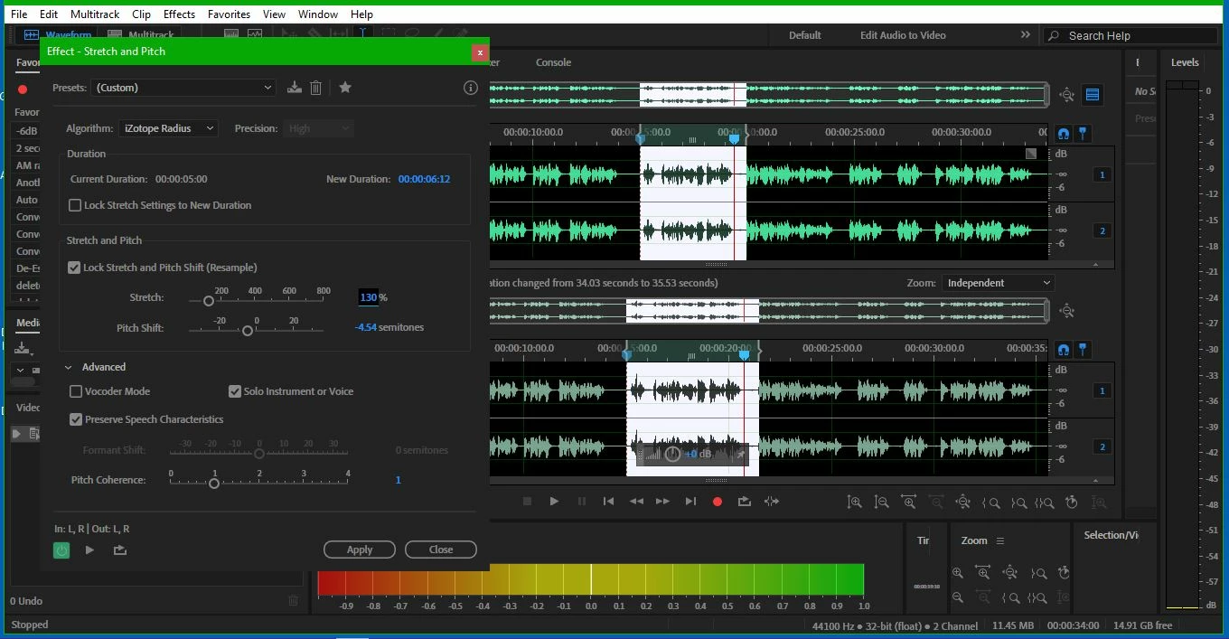

This is a screen-grab of the process at work:
This is using the Preview editor to show what happens to the duration and pitch. The one difficulty you will have with this process for what you want to achieve is that it doesn't cope with gradual changes - you have to use it in sections of fixed change.

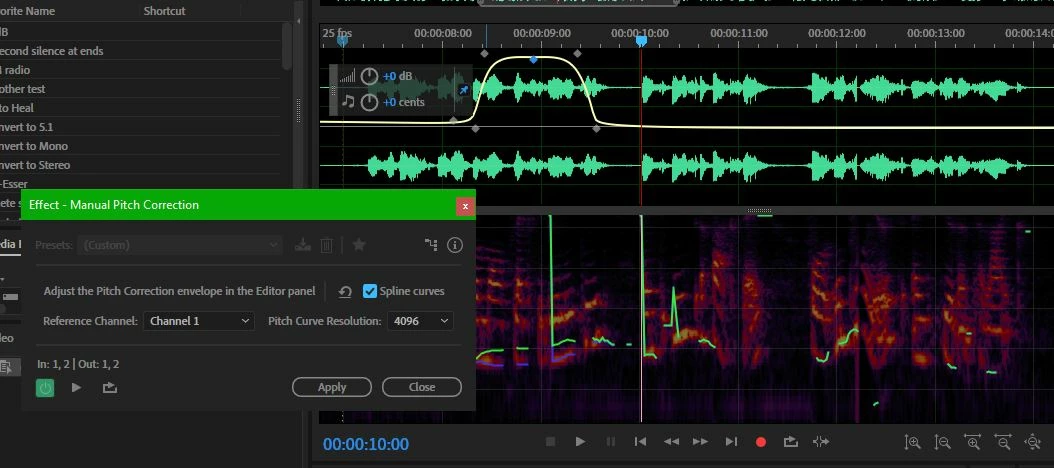

As an alternative you might like to try manual pitch correction, but this will only alter the pirch, not the duration. Assuming that what you need to compensate for is a pitch and duration issue (like wow), then ideally you need to vary both together, which you can only do in sections as shown above. Manual correction uses a rubber band and you can spline the curves to be smooth, but won't correct the time distortion. It looks like this:
