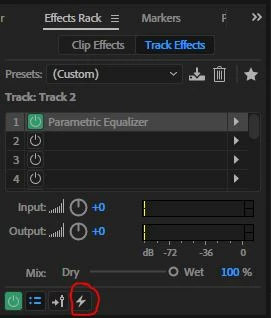

Thanks for sharing this.  My problem (8/2018) is that I do not see any lightning bolt symbol at the bottom of the effects rack.  I DO see a small window that I can toggle open, which shows input and output meters, and gives me the option to process the selection only or the entire file.  But alas, no lightning.
SteveG_AudioMasters_
Aug 9, 2018 8:30 AM UTC
It should look like this (circled in red):
And no, you can't hide it!
