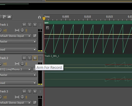

We've got a bug written to investigate this further.  With the basic output->input latency test, I'm seeing much higher-than-expected latency values at almost all sample rates on Mac OS X.  I'll incorporate the notes from this thread into the bug (I've already put a link to it) and look for topomorto's related bug so we have all the information together.
Thanks!  Y'all are awesome.
Dec 19, 2011 8:33 PM UTC
...and look for topomorto's related bug so we have all the information together.

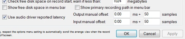

There aren't any user-facing parameters for latency-compensation.  I'm seeing similar results on my Win7x64 system as well, and the bug has been assigned to a developer for additional research and fixing.
I'll let you know what we find, and if I can offer any advice for now other than manual adjustment.

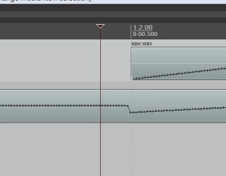

It was recommended to me to try Cockos Reaper, and lo and behold...
    Absolutely spot on, to within a sample or two.

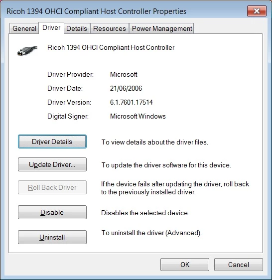

          I was considering grabbing a firewire interface from ebay but I have a dreaded Ricoh chipset so not sure if that's just going to be a different kind of pain.

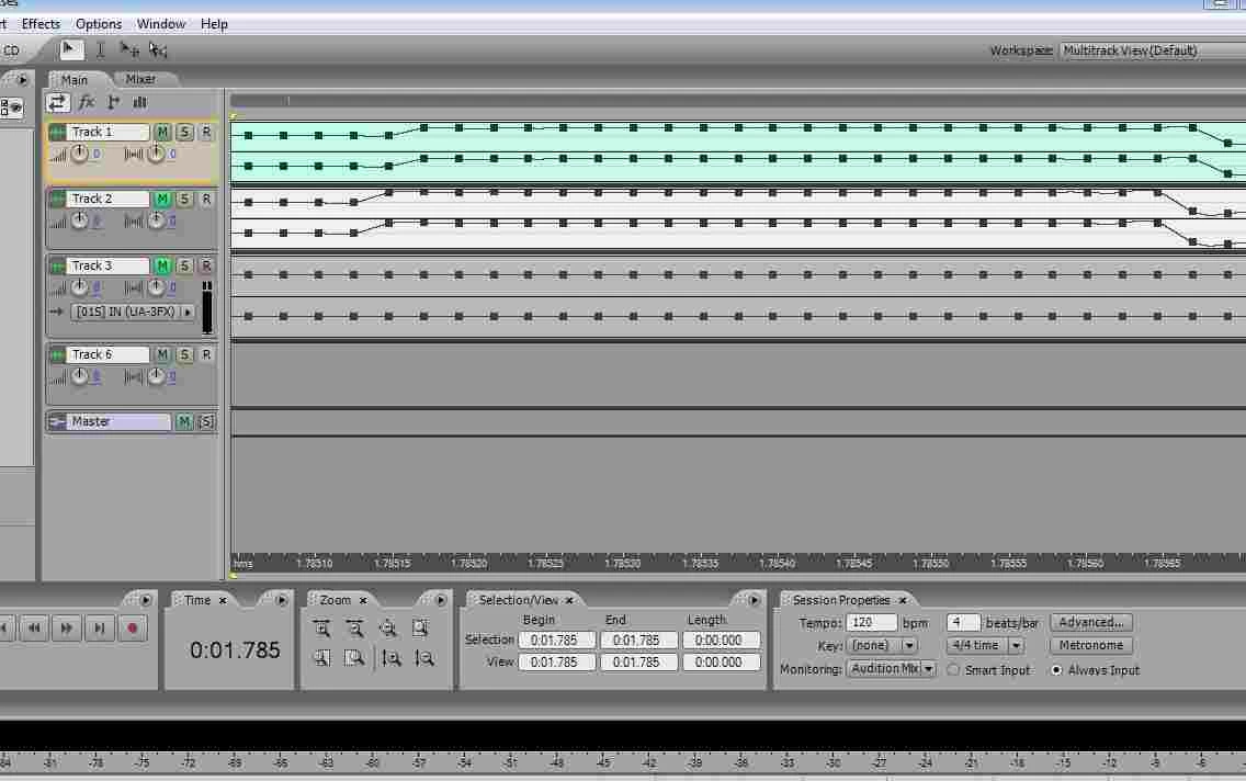

Nov 30, 2011 4:28 PM UTC
What we have here is a screenshot showing that the audio (a square wave) passing through Audition 3.01 via my UA-3FX using asio has negative latency.
The top track is the original The UA-3FX is plugged analog output to input. Track 2 is the recording of this signal using asio.
Track 3 doesn't show the signal recorded through the same hardware loop using the WDM drivers. The latency in that case is approximately 70 ms so the square wave is way off to the right.
There obviously is some sort of compenstion occurring somewhere when asio drivers are in use.
