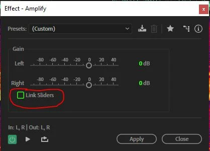

Use Effects>Amplitude and Compression>Amplify.
Important - make sure that there isn't a check in the Link Sliders box or this simply won't work, as both sliders will move, whatever you do. Now find the quieter channel and move the slider for it to the right. You can get a good idea of how this is working by using the Preview play button at the bottom of the box. When you've found the correct level to get them balanced, hit Apply and your file will be corrected.
