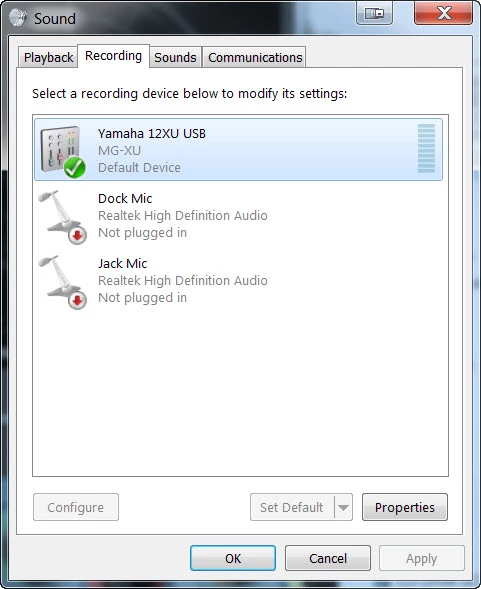

    In any case to the above, you'll also have to select/match the input via the PC's Sound panel, in the recording tab.  You can find "Sound" in the Control Panel.

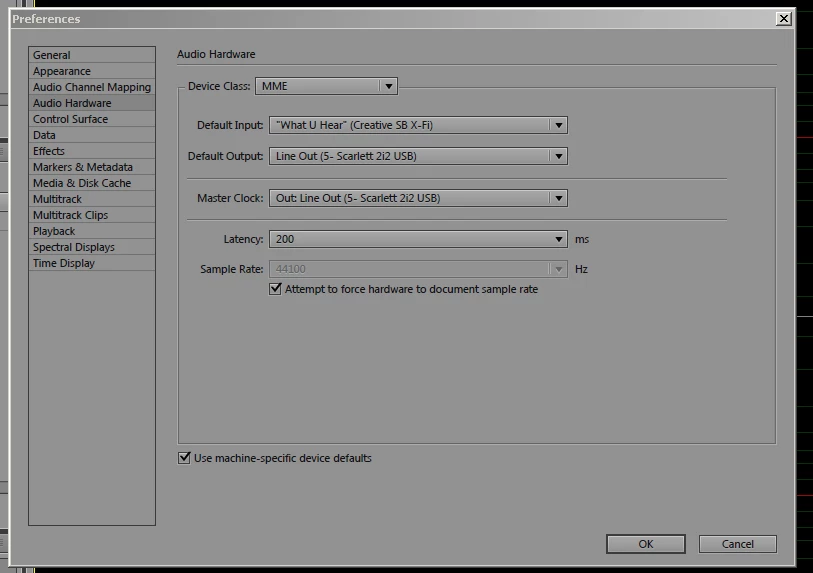

    Thanks and Bob.  I do have the 'What U Hear' option within the Recording Sound options in Windows 7.  I also see the option within Adobe Audition itself when I go to the 'Audio Hardware' section in the Preferences Menu.  However, an error message prompts when trying to record that reads, "The sample rates of the audio input and output devices do not match.  Audio cannot be recorded until this is corrected.  Use the appropriate operating system or audio device control panel to adjust the sample rates of the input and output devices to use the same settings."
    I will try uninstalling/reinstalling my Creative SB X-Fi sound card driver to see if that helps.  The Scarlett Focusrite 2i2's sample rate has to be changed within a program.  There isn't a control panel for the device that you can install to my knowledge.  Here is what my screen is set to now:
    Let me know if you guys have any ideas on how to fix this.

    I'm pretty sure the "What U Hear" is a function of the Creative card so I wouldn't delete it just yet.
    It's been a long while since I've had any Creative product...does it use its own software control panel or does it use Windows like the old Sound Blasters used to?
    If it's Windows, the fix might be easy.  Go to the Windows Audio Control (either via the Control Panel or right click to loudspeaker icon in the bottom right of your screen.  Click on the Recording Devices tab, highlight the Soundblaster item you're using and click on Properties.  In the properties menu there will be a drop down menu where you can select the sample rate and bit depth--make this match what's set in Audition and on the Scarlett (you may need to experiment if you don't have the details).
    Note though that trying to use two different sound devices at once can mess things up so that might also be part of the problem.  For What U Hear you might actually be better off using the Sound Blaster for in and out, then switching to the better card for later editing a mixing.
