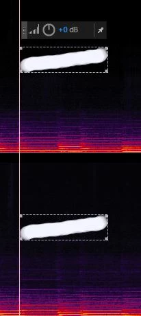

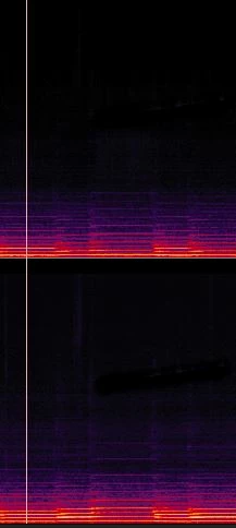

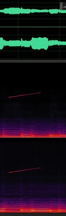

The best solution to this is almost certainly to 'look' at the sound in the spectral editor (underneath the waveform) and 'paint' it out using the paintbrush tool and the HUD volume tool that comes up when you've made a selection. Most squeaks can be quite clearly identified, as they look like slightly curved horizontal lines (they are curved because generally, they aren't at just one frequency) but you might need a slightly bigger brush size than you think - possibly up to about 20 pixels. Here's an artificial one I created:
Make a selection with the paintbrush and turn the volume right down...
Poof! All gone!
