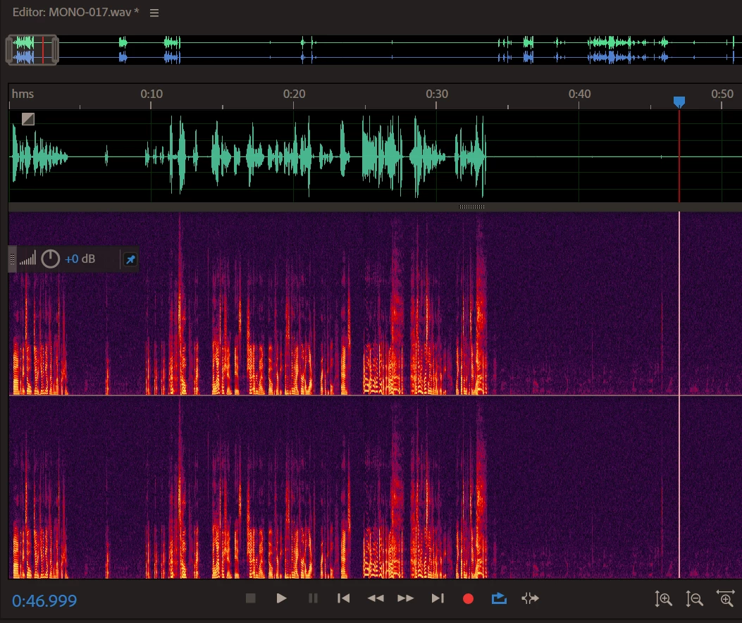

I am editing some audio and trying to use the match loudness function to bring the audio from -32 LUFS to -16 LUFS and when I do so, it amplifies a lot of the fuzz in the background that you could not hear in the original.
Here is a screenshot of my audio before running Match Loudness:
And here is a screenshot of my audio after:
Should I be making it louder in a different way to avoid this problem, or should I just treat this amplified noise as background noise and try to reduce it using the Noise Reduction tool?

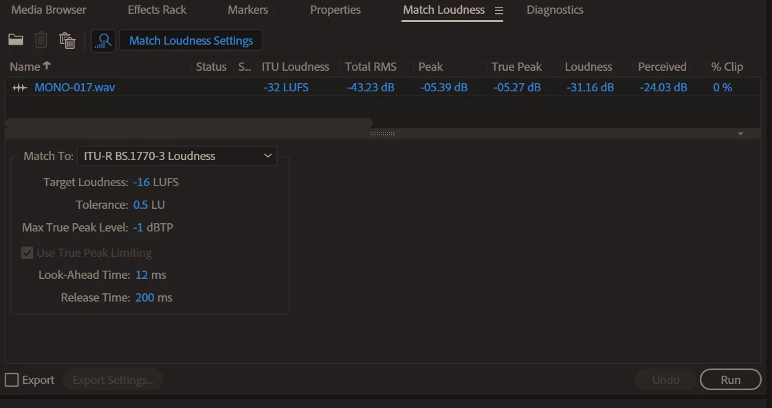

Here is a screenshot of my settings when I run Match Loudness also:

1월 13, 2021 11:17 오후 UTC
The noise is there anyway. If you amplify the signal by 16dB, you amplify the noise by the same amount. And anything else you do to the signal itself, like compression or limiting which would even the signals out, is going to make the dynamic range worse. And that's what we are looking at here - the dynamic range of the signal. And that isn't affected by the absolute level of it at all.
So if the noise rises to an unacceptable level, then the only thing you can do, as you've surmised, is to use Noise Reduction. This will leave the peaks of the signal alone, but lower the noise floor - thus increasing the dynamic range. Generally the thing to do initially is to normalize the signal to 0dB and then find out what the noise floor value is. Then make adjustments so that you keep the average level comfortable without loads of peaks. On your example, I found that Audition's DeNoise works surprisingly well, although like most NR, it's best run twice at a moderate setting. If you run it twice at 50%, that leaves you with a LUFS value of -15.64 and your side of the conversation at least, pretty clean.

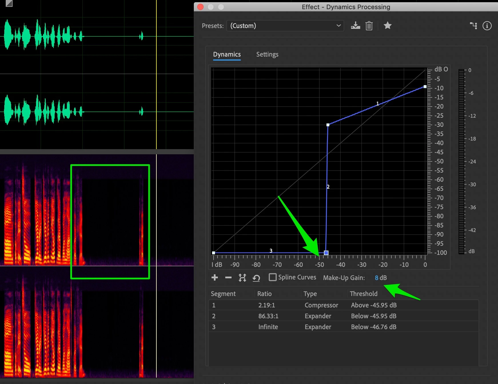

An alternative here would be to not amplify the noise.
Use the noise reduction tool purely to find the noise floor.
Then use the dynamics processor to amplify the voice but not the noise.
Something like this perhaps:
This is a snapshot after dynamic processing with the settings as per the green arrows.
All the dynamic increaase in volume is above the noise floor so the signal to noise level is improved.
The green box shows that the noise level has not been amplified.
번역
Best regards, Euan.
SteveG_AudioMasters_
1월 14, 2021 4:06 오후 UTC
The trouble with doing it the downward expansion way is that it sounds terrible, because you lose the ambience disproportionately - which is why we never recommend it unless it's in desperation. The general aim is to get the best result you can with minimum degredation of the audio - which is why NR is generally a much better way to go.
번역
EuanWilliamson
1월 14, 2021 4:35 오후 UTC
Thanks Steve, that's an interesting view.
For me, it sounded pretty good.
Perhaps it's one of those by case by case things.
For my own education, I'll try both methods on the file posted and test my ears 🙂
번역
Best regards, Euan.
