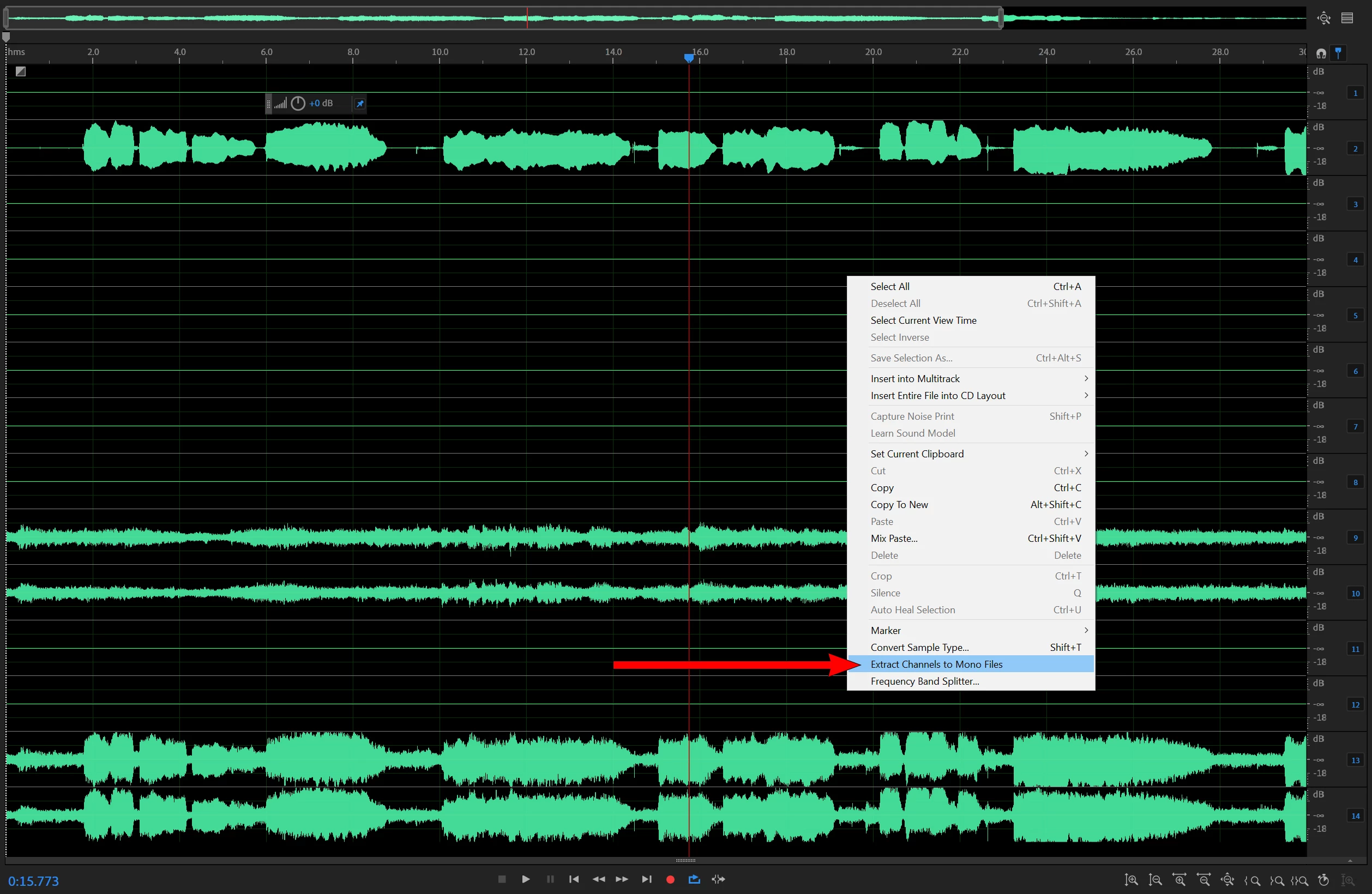

Oct 20, 2022 10:19 PM UTC
"Extract Channels to Mono Files"
This works for me (I'm assuming it's the same issue). In this example, only the top track would play - Track #2. This WAV file has14 total tracks (see attached image). I simply break them up into 14 separate mono files and drag them into a multitrack session (Right-click > "Extract Channels to Mono Files"). Works for me.
