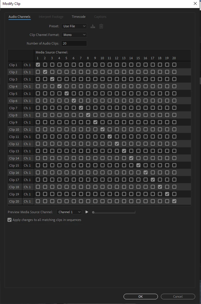

Feb 3, 2021 10:01 AM UTC
Here'a a 20 channel polywav split to 20 mono tracks.
SteveG_AudioMasters_

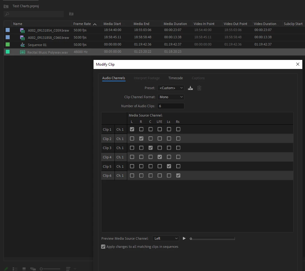

Feb 2, 2021 10:17 PM UTC
In Premiere if you right click the polywav file in the project panel and select 'Modify Audio Channels' (you can select more than one clip if you want) you have the option to select what track format you want. My screenshot shows a 6 channel polywav broken out to six mono.

Feb 2, 2021 10:51 PM UTC
That's what usually happens when I say something like that 😉 but...
If I put a polywave file with 12 tracks into it, what happens then? Premiere only appears to be allocating the six channels of a surround wave into output tracks. What Audition does looks to be way more flexible than that, as you can put any number of tracks wherever you like in your layout, without any limitations.
