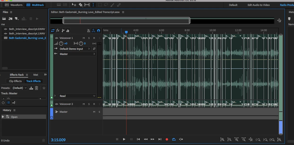

SteveG_AudioMasters_
Aug 21, 2018 10:02 AM UTC
alessandraw39644032  wrote
when I export the session from Descript and try to open it in Audition, there's no sound! The level meter indicates zero output when the session is playing.
Has anyone else encountered this problem, or have thoughts on it?
I have one very simple thought, and that is that .sesx files don't have any sound in them anyway! All a sesx file is is a descriptor for a session - the audio still has to be imported as actual audio files before you'll hear anything.
So do you see an actual waveform on the screen?
Aug 21, 2018 4:57 PM UTC
thanks for writing, Steve.
I do see a waveform in the DAW, and on the lefthand side it does indicate that the .wav files are present. See image below. Maybe you'll see something I'm missing? I'm stumped.
