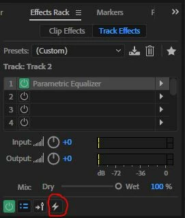

Need more information, really. It sounds as though you've got processing applied to a clip that might need pre-rendering before the mixdown. If you set up your clip with whatever processing needs doing to it and hit the little lightning bolt at the top of the effects rack, it will pre-apply all of the effects before the actual mixdown for export. I'd try that first before looking for anything deeper.

I've been pre-rendering effects on these tracks already, so I don't think that's the issue. When it distorts, the audio sounds like it's echoing and a little muffled at the same time. I'm wondering if it's a stereo versus mono issue? I have no idea whether the mic I used records in stereo or mono, but my setting in the input/output on the tracks was set to mono external microphone. If the recording is actually in stereo but the setting is different, could that be the problem? I feel like this problem often happens when the left and right audio levels don't appear to be equal in the playback bar, which is why I'm wondering if it's related.
