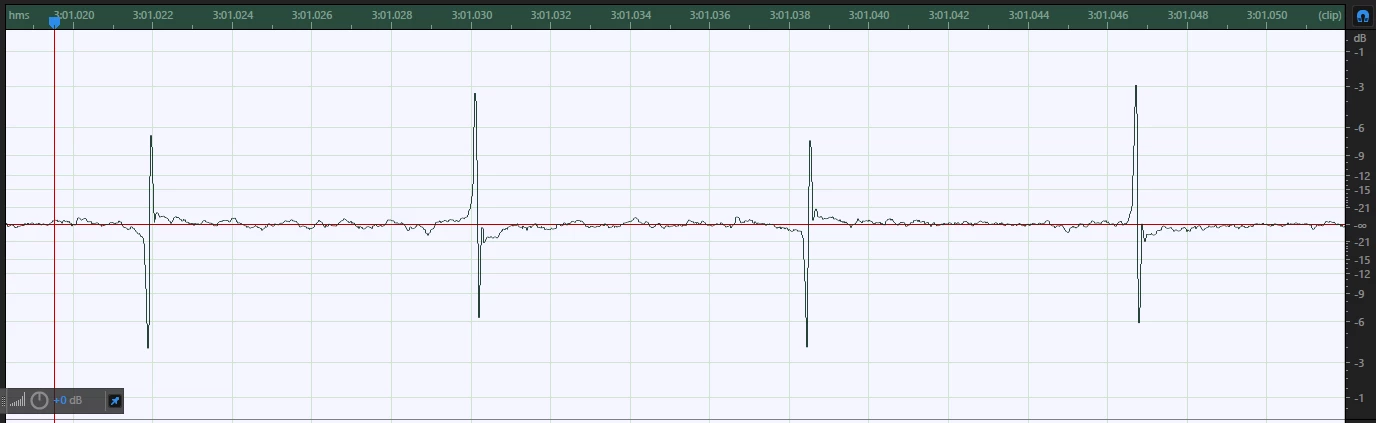

Here's the signal, with the noise spikes (note the vertical and horizontal scales! it's zoomed *way* the heck in):
If  I zoom back the time scale, I can see the voice contours under the noise, too, and hear them when I play it. Obviously the level of the actual voice is tiny.
Those spikes occur at pretty close to 120Hz, but I haven't found frequency-selective methods to be at all effective at disposing of them.  And I don't understand why, either.  (I'm assuming the offset from 120Hz is due to variation in original tape speed, or even perhaps in playback since that deck is nearly as old as the recording. It does vary measurably from place to place on the tape, but it's like 121.97 Hz here and 120.5 there, or some such.)
Looking for the actual vocal peaks and putting in a hard limiter just above that works as I would expect -- the noise is still mostly louder than the voices but not by nearly as much, so it's not as painful when I then boost the gain to make the voices properly audible.  So, that helps some, but doesn't solve things.
I've played with various frequency filters, including the de-hummer, and get surprisingly little audible effect (set for values around 120 Hz, and it doesn't seem to matter much where).  Asking it to output the hum shows it's getting some ordinary hum, but it has little effect on these spikes.
I keep thinking that, in theory (if there's a tool available to do this), you could look ahead just a bit for the spike crossing the top vocal peak level, and then simply zero the signal for the amount of time until the spike ends.  I don't quite see how to do that with existing tools, and it would probably still leave audible wreckage behind, but it should take the noise down a lot further than the limiter does, shouldn't it?  Almost an inverse noise gate -- when the level exceeds -15db flat-line it for a few milliseconds.

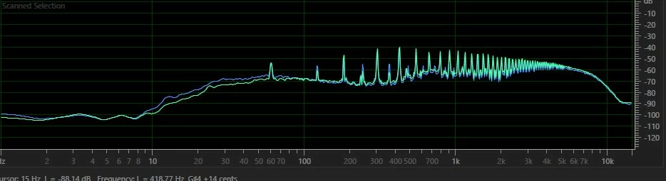

I had a look at the entire file, discovered that the sound removal tool won't touch it, and then had a careful look at the spectrum of the noise, which looks like this (this is a large section analysis):
All those spikes sit pretty still, and judging from the sound (and the fact that there's a very short snippet where the noise disappears of its own accord), I'd say that the most likely cause of this is an extremely dodgy connection between what played this back and whatever re-recorded it. Specifically, it sounds like an earth return fault, where the signal return - what there is of it, that is - has gone via a route that includes most of the street wiring!
How do you get rid of it? The notch filter is probably your best bet, and you'll have to use a lot of instances of it - the effects rack may help here. You'll have to do what I did to analyse the sound, and then zoom in a bit to get all the numbers and relative levels. Concentrate on the largest spikes first, and be prepared to spend a lot of time experimenting. One trick you can use to make sure that you have the filters set at the correct frequency is to push them positive, and sweep them slightly - you'll very easily hear what you need to set them at, and then drag the one you're working on negative. If you want a clue to what the actual numbers are, it's every harmonic of 60Hz up to about 6kHz. The even harmonics are at a lower level than the odd ones, so you might want to treat these separately in a separate instance of the notch filter.
How well this will actually work depends upon how accurately you can carry this process out, and there may well be something to be said for not attempting to go all the way with this, as you'll possibly lose too much of the original.
Anyway good luck - you're going to need a big dose of that...
The other problem is that because what ever the fault was any wanted audio sounds like it is just capacitive breakthrough, thus it is heavily high pass filtered and contains no lower frequency energy. So there is virtually nothing left even if you can completely eliminate the 'buzz'.

I did go in and manually wipe out each spike, doing by hand what I described a filter potentially doing.  It worked well enough, got rid of most of the noise and made it easier to hear the underlying signal.
Which allowed me to confirm ryclark's prediction that there wouldn't be anything useful left under the noise.
(The places where I can hear words through the noise -- because the actors were shouting, basically -- I can recover those words more clearly with this technique, but they are sparse enough not to amount to anything.)

Also it might be easier to isolate and identify the noise looking at the audio in the Spectral Frequency display in Audition. You could post a screen grab of the Spectral view here as well to help us identify the noise. There you should be able to see how it varies over time and make it easier to deal with. However whatever you do is going to be a rescue job with not ideal results due to the major difference in level between the wanted and unwanted signals.

I've played with frequency filters of several kinds, including the dehummer, and tried frequency-domain editing in the Spectral Frequency Display, and have gotten nowhere at all. I've used those tools for other things quite successfully.  It's been a while, and I was a pure math student not applied math, but...doesn't a single sharp spike like this noise contain frequencies all over the place?  I knew the FFT math in theory long ago :-) .  Anyway, what I've tried hasn't helped, but I'm not very experienced with this level of audio either.
