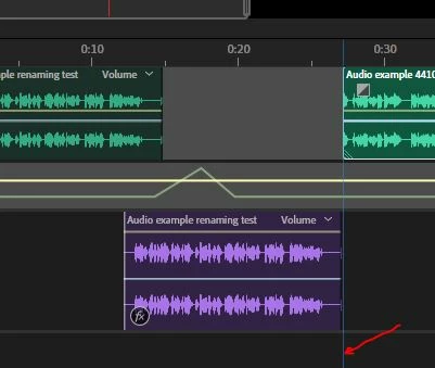

The 'insert silence' method is fine, as it lengthens the session, rather than moves the clips - so the relationship between any other clips is maintained. The alternative is to group anything beyond the insertion point, and move the group along, leaving a large enough gap to insert your clip in. You can then realign the clips easily, as long as you have 'snap to clips' enabled; get your inserted clip lined up against the left hand clip, and then slide the grouped clips back to meet your inserted clip. You get a blue line to help you as well, as long as you've enabled the snap:
The blue line shows up only when you are within the snap range. Of course this also means that you don't really need to put your insert on the same track...
