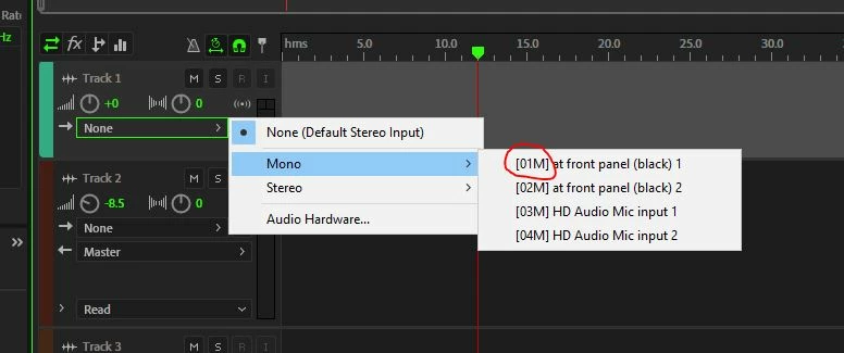

    When you say 'I've selected just input 3 or 4' do they indicate that they're mono or stereo? If you pick an entry with an S in it, even though it only indicates one channel, it will record the channel paired with it as well. The correct way to set this up would be to create a mono track, and select an input with an M in it:
    And that should put a single mic on a single track.
