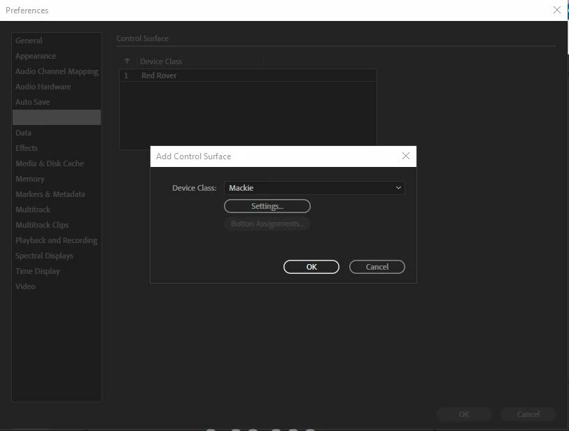

This is how you make it work
It worked for me on audition and premiere, what you have to do is to unnplug the nanoKontrol, then press and hold still "set" + "backwards"  until this last start to blink
then open Audition or premiere, then go to preferences, add surface control, add a mackie control, on adjustments select both input and output the nano Kontrol.
You´re ready to use it
