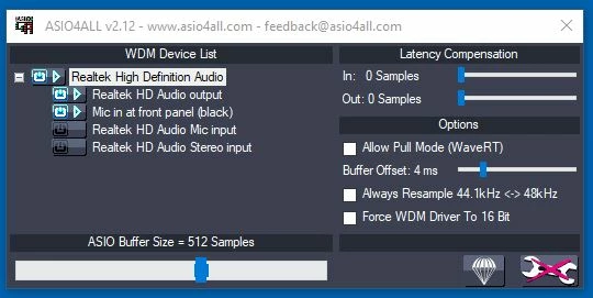

    Never mind, I'll tell you anyway. Firstly, it doesn't make any changes to your computer, as such, at all. Secondly, we've been using it for many years now as a diagnostic interface, and there's nothing better available, certainly at the price. Audition's audio 'engine' is fundamentally an ASIO-based one, and ideally is best used with a manufacturer's ASIO driver, but they are generally not available for built-in sound devices. What ASIO4ALL does is to provide an interface between Audition's engine and the sound device driver Windows provides. Most importantly though, it diagnoses the state of the device, and tells you whether you have significant issues with it. Internally, Audition has something very similar to ASIO4ALL to operate with Windows drivers, but it's not visible and has no diagnostics as such. ASIO4ALL is simply replacing that with something you can see!
    As a result of Microsoft's upgrade though, you may need to download from HP a revised sound driver; I have read some comments on the HP forums about people having similar problems to yours, and checking and updating that driver would be one of the first things to check. But initially, try selecting ASIO4ALL in the device class, click on the 'settings' button and have a look at the display - click on the spanner in the lower RH corner, and you should get a display like this:
    If it looks exactly like the picture above (this is from my HP laptop, incidentally) then the interface is working fine, and we'd have to look at the sound settings elsewhere in the machine.
