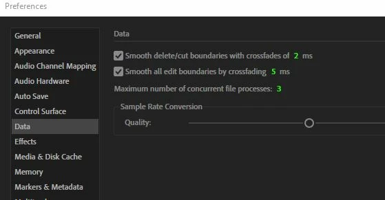

Unlikely to be a bug (we'd have spotted that pretty rapidly) and latency only affects the way the output gets to your sound device - if it's set too low then you'll end up with 'interrupted' sound, but not clicks and pops. There's no way that Autofade between clips can eliminate anything that happens at the very end of a clip - it will only have its level halved at the crossover point. So what else?
First thing to look at is in Preferences>Data. At a bare minimum it needs to look like this:
If you turn either of the first settings off, then you are very likely to have any edit where the crossing points don't line up coming out with a discontinuity, which in a bad case can be like an explosion. If this doesn't make any difference, then if you could post a small example, it might be a lot easier to establish exactly what's happening.

Many thanks for this. My settings are as above so that's not it.

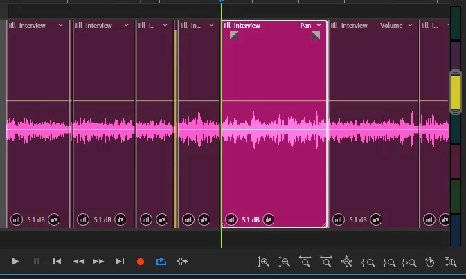

I've attached a clip - you should hear a few different sounds where the cuts are, ranging from surge like sounds to bumps: https://we.tl/t-5C2hAtYLA9
This is what it looks like in the timeline (suspiciously free of auto-cross fades....!):
I've been playing about with the effects on Jill's track and it feels like there's something going on with cuts and the processing on the Dehum RX plugin. I'm wondering if RX senses the edit point, stop the processing a millisecond before the cut, resulting in a tiny segment of untreated audio - is this possible?
The only way I can think of remedying the problem is processing Jill's audio in RX before re-importing into Audition.

Mostly what I can hear here is poor mic technique, which is what's causing the low frequency 'bumps' - that's blast noise, which gives you the popping 'P's. What happens with DeHum is that you have to be very careful with it - if you use too steep a notch, you can make the hum sound worse, not better (there's a complicated explanation for this that I won't bore you with), but the upshot is that the hum is perfectly capable of being modulated by the speech - which is what it sounds like in your case. It's not actually sensing the edit points, but it is reacting to the content...
Basically you should only use the DeHummer when you're absolutely desperate; Noise Reduction generally does a better job. And yes RX is pretty powerful stuff - rather easy to abuse without realising it! The popping 'P's are relatively easy to remove in Audition. Once you've learned how to spot them in Spectral view, you can generally get rid of them with the AutoHeal favourite. As for processing in RX before importing - well that's what I always do, if I need to.
