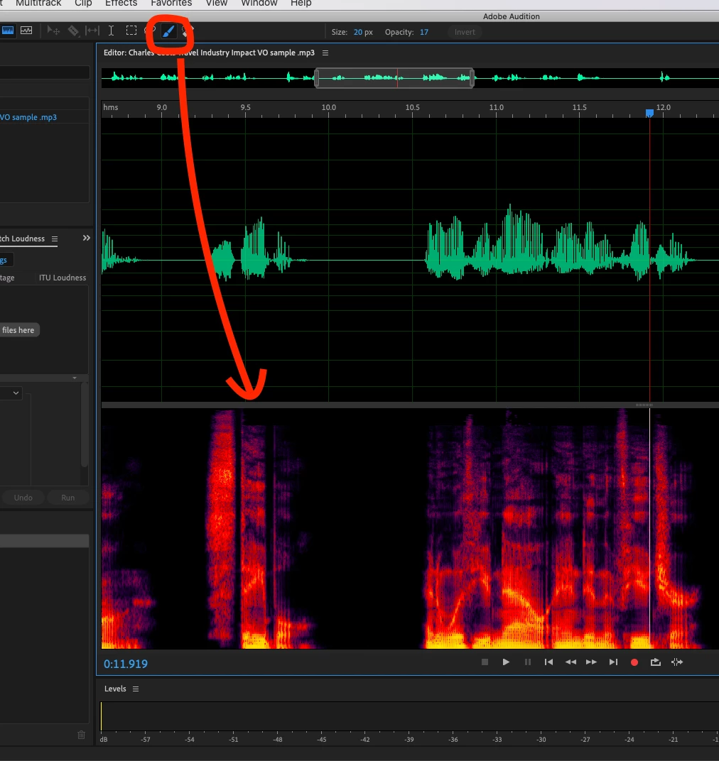

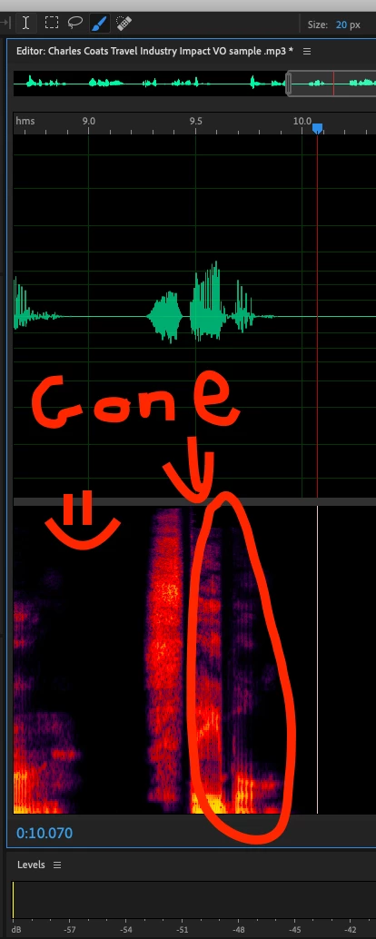

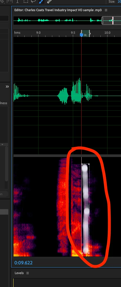

Hi there, one way that night help out is to use the Spectral Frequency Display.
I have put my descriptions of each step in the pictures so when you click on them it will tell you what to look for and do in each step.
Hope this help my friend. Good luck.

So you didn't read the bit about 'overlaps', then?
Nov 20, 2020 3:44 PM UTC
Hi Steve,
I did. He mentioned that it was a " Sharp" sound. Using spectral Frequency you can see the where the sound lands in the frequency range Sharp sounds are usually furthur up on the frequency range or come out as a brighter color spot and he can pinpoint the chirps, etc... and he can also adjust the opacity of the brush head the take off smaller or deeper layers and the thickness of the stroke itself also in order to be a little more accurate and fine tune as he removes the unwanted noise.
