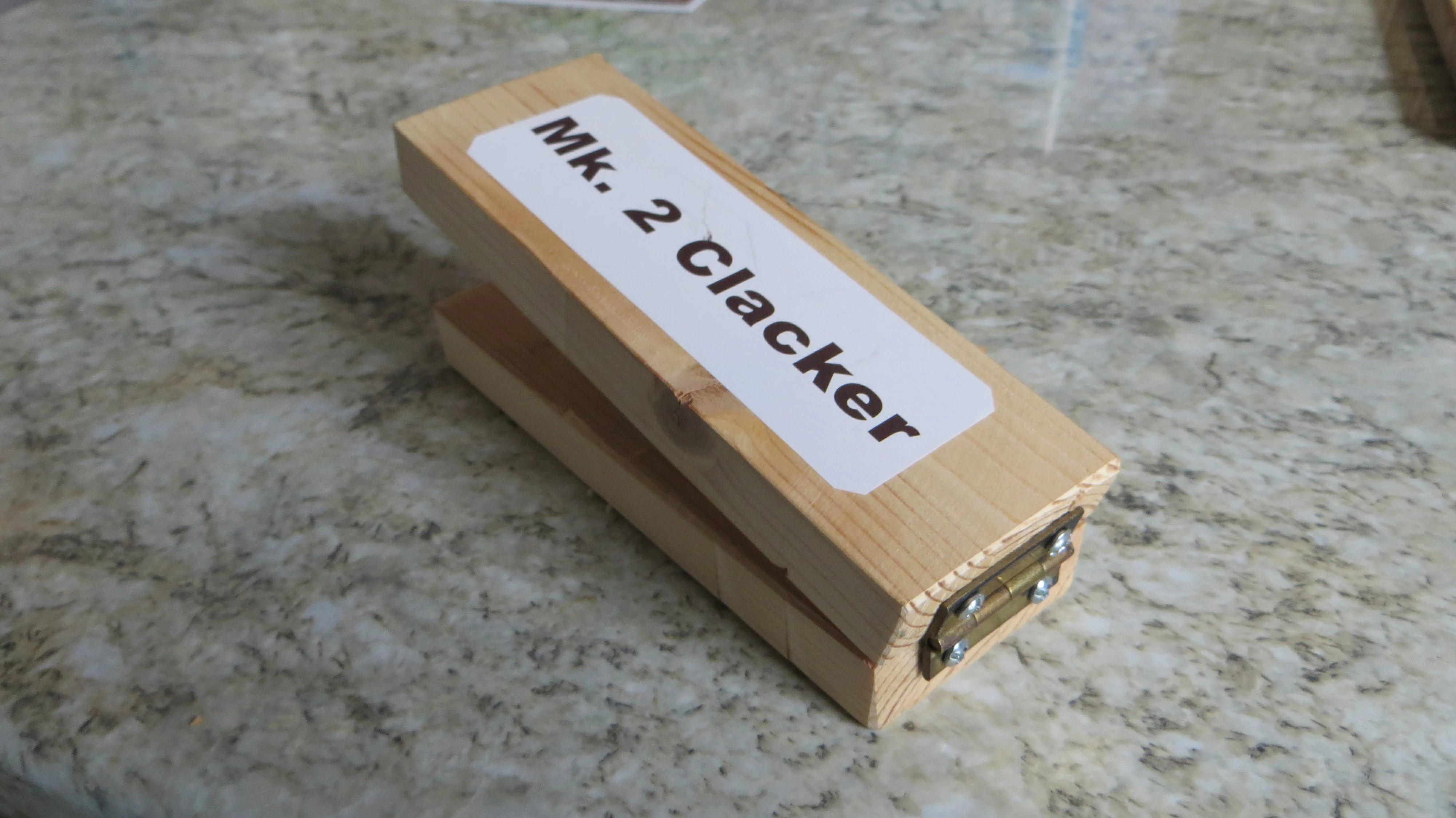

As an alternative to clapping (which certainly does like conceptually the wrong thing to do!) try making a mini 'clapperboard' out of two bits of wood joined with a hinge at the end. If you screw it to whatever they are using as a lectern, then all they have to do is pick up the other bit and snap it down. Sort-of like this:
 (Yes there is a Mk 1 but it's a lot bigger and louder)
