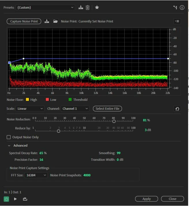

The basic rules for not screwing up process-based NR are: Only work on a copy of the original. Start out with the highest FFT setting, and don't take more than about 3dB off. Repeat that twice more, each time with a lower FFT setting but still not taking off more than 3dB. Yes, you have to resample each time which is a pain, but this is also what stops the process screwing up. Quite often with a lot of noise, it's worse at lower frequencies, so you can afford to tip the graph down a bit, which means that your LF noise gets slightly more reduction. Typically, a pass looks like this:
It is often worth experimenting with the Precision Factor and Smoothing values - everything else can pretty much stay as it is.
