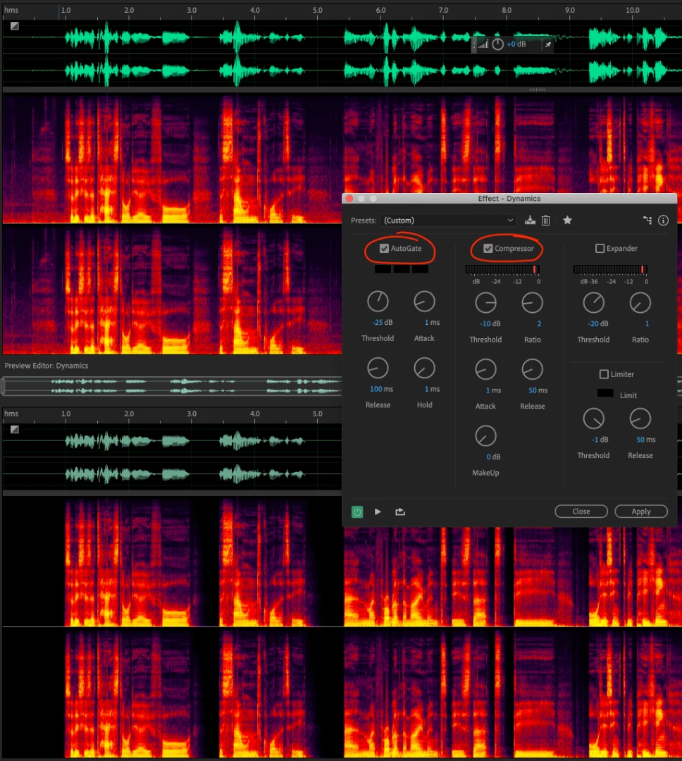

    Mike Russell
    Aug 5, 2019 8:55 PM UTC
    It sounds pretty reasonable for the make and model of microphone you're using.
    If you can turn down the input going into Adobe Audition using your Windows audio controls that would help prevent the peaking you're getting which you certainly don't want in your final recording.
    What will you be recording on your microphone harrys65643539​? Your answer will influence the type of replies you may get with tips to improve quality.
    Like ryclark​ mentions there is a fair bit of background noise in your recording. Open up Spectral Frequency Display and you'll see it. I've attached an image with some basic settings to help reduce that using Effects > Amplitude and Compression > Dynamics... first the AutoGate to stop background noise getting through (look at the before and after in the screen shot) and a little compression to even out the volume levels of your voice.
    There's also some sibilance in your recording Effects > Amplitude and Compression > DeEsser... would fix this. There's also EQ to consider but one step at a time. Let me know how you get on!
