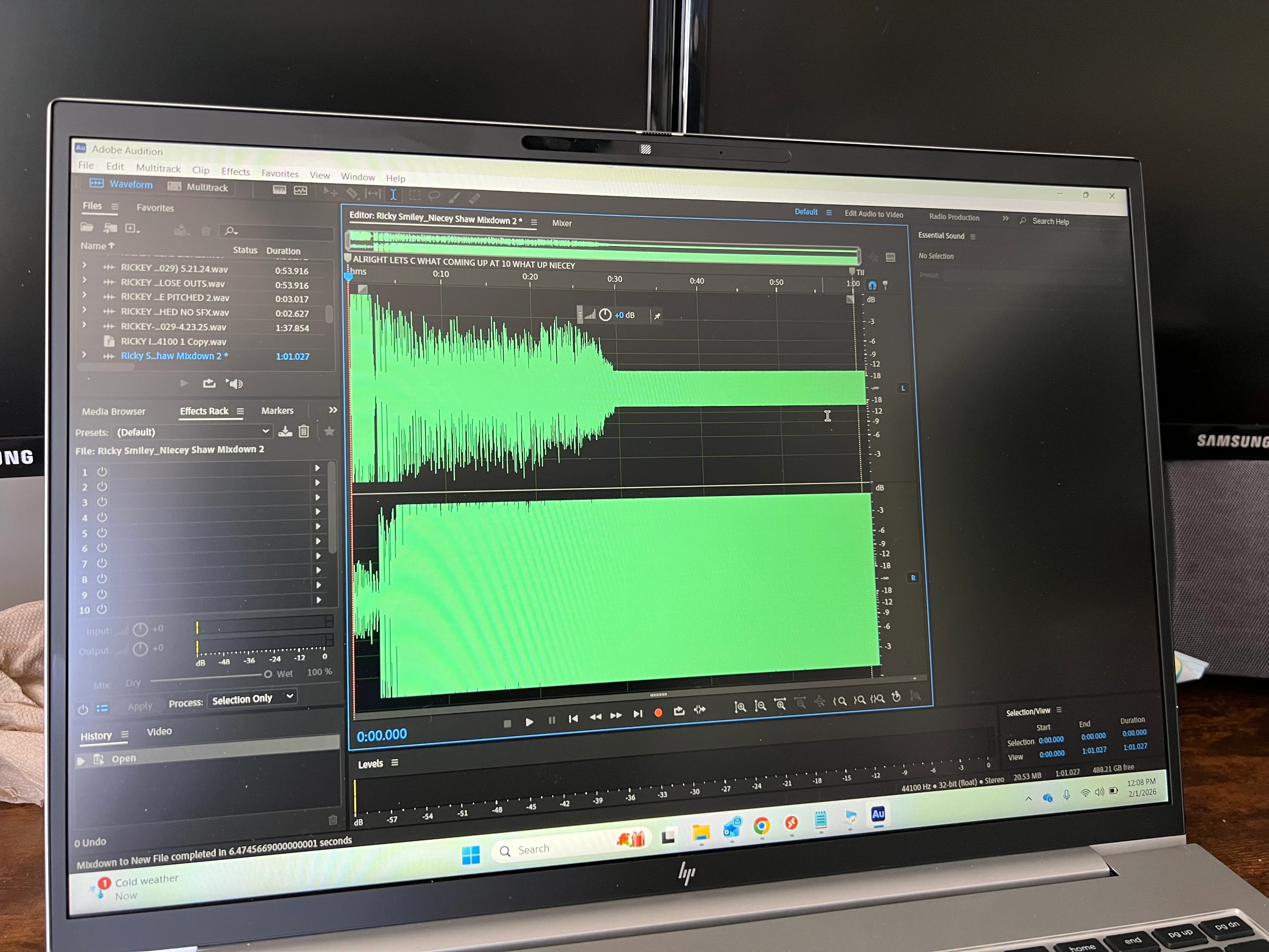

    Thank you for your suggestion. Tried what you suggested and it exports down the entire session. Weird!!!
    I am trying to mixdown 5 audio pieces ( 2 short music pieces and (3) vocal pieces). The total run time of the piece is 30 seconds. When I mixdown selected clips or export selected clips, it gives me a one minute piece of audio that has buzzing all the way thru. (see attached photo). The levels do not match on the right and left side.  So weird!!! This just started happening with the switch to version 26.

    Okay - this has some of the hallmarks of a corrupt session file… Just to find out if this is the case, can you try reassembling the session again from scratch? I realise that this is a bit of a pain, but these are the steps we need to go through in order to pin down exactly what’s happening.
